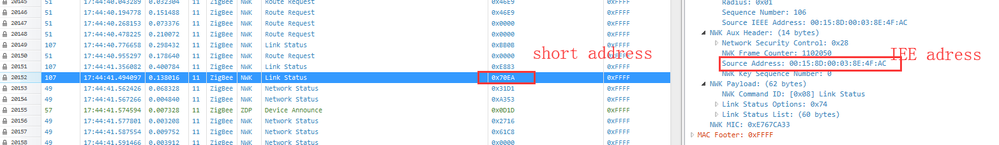

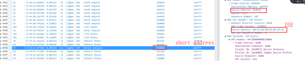

Hello, everyone, in the process of allowing the network, we found that the short address of the devices that have already entered the network has changed. Sometimes my coordinator doesn't know that the device's short address has changed. Why does the address of the device already in the network change?
Here are the screenshots and packet capture logs of short address changes
After change 0x0d1d
The attachment is grab bag

The issue seems related to a possible address conflict happening when your device sends a Link Status, causing the device to handle the conflict and changing the Short Address in the process.
Maybe some section of code could be assigning the same address to multiple devices.
ZigBee 3.0 automatically handles these conflicts by changing the address of the device.
For more reference, please take a look at the ZigBee 3.0 Stack user guide, here.

Thank you. I see the short address conflict. I see that it will send device announcements once, but sometimes my coordinator can't handle it and can't receive it. How to maintain the application layer when the short address changes? How is ZigBee 3.0 handled?

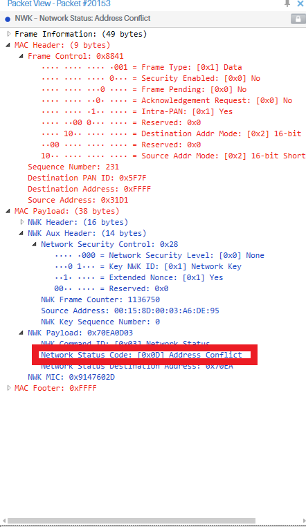

If there's an Address Conflict error, you should be getting a Network Status packet containing the corresponding error code, 0x0D. If this error code is detected, you could use this value to detect the address change, and perform the necessary execution modifications.
There's currently a newer SDK version available for download (currently, the latest version is 1840).
It can be found on this page of our website, here.
Could you please try updating to the latest SDK version to see if the problem persists?
