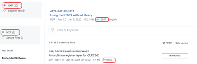

I have an NTAG5 connected to an CLEV6630B DevBoard. After sending an Read SRAM command (0xD2) I got a card response 0x73, which is pretty fine. I could see the response data in the "Tag communication" tag of the NXP-NFC cockpit under "Card Response".  Up to there I am satisfied. Know I want to read the responsed data directly.
In which register of the CLRC663 could I find the received data? I hope to find them in FIFODATA_REG, but there I only could read 0x00 instead of the expected 0x73.

Based on your description, there is an example based on LPC1769 MCU can be helpful to you. Please go to CLRC663 plus family | Low-Power NFC Frontends | NXP Semiconductors download the following source code and application note.
