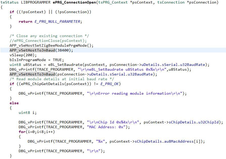

Hi, Sebastian Thanks for your kind replay.
I'm doing program JN5169 through FW.
Note - Host-JN5169 is working at 115200 baud rate
Following are the steps to update JN5169 from Host(using  firmware)
1)The host is changing current(115200) baud-rate to 38400.
2)Sent "Change Baud Rate Request" to JN5169.
3)Wait for the "Change Baud Rate Response" from JN5169.
4)Once "Change Baud Rate Response" from JN5169 Host is change baud-rate to 115200 from 38400.
5)Start further process(Read module details and extract FW information from FW and start flashing FW in JN5169)
Feel free to ask more information.

Hi Hiren, I hope you're doing well!
In programming mode, JN5169 devices can be programmed in a 1000000 Baudrate, which is the default option when opening the device programmer in BeyondStudio IDE.
The 8, N, 1 refer to the UART configuration used for programming:
  • 8 refers to 8 data bits each packet.
  • N refers to the fact that no parity is being used.
  • 1 refers to the use of only one stop bit to end of the transmission.
