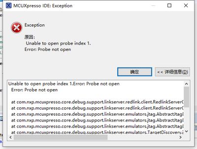

Unable to open probe index 1. Error: Probe not open

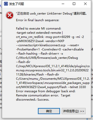

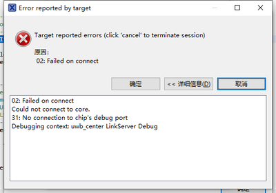

I'm using micro-usb for power supply and openSDA to debug the KW36 board
IDE mcuXpresso can probe the cmsis-dap, but show err msg as below
frankli2021_0-1632712276716.pngfrankli2021_1-1632712282151.pngfrankli2021_2-1632712286949.png
And each time I have the problem, reboot pc w'll be ok in new debug session

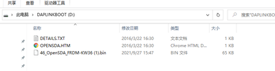

nxf56274
把debug固件改成jlink。长按复位按钮,然后插usb,磁盘应该出现一个类似daplinkboot的盘符,然后把附件解压,把bin文件拖进去,然后再试试
