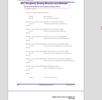

Hello everyone, I would like to add a radar (equivalent to PIR) to the bubble light zigbee. I would like to set the sensitivity of this radar, which cluster ID, attribute ID, and command ID should I use? Is there a standard way to write this in zigbee3.0?
I want to use the clusterid of the radar as the cluster ID of the occupancy-aware cluster as 0x0406. However, no attribute ID of sensitivity was found。
All attributes of the occurrence aware cluster as 0x0406 in the screenshot above,but there is no sensitivity attribute。Looking forward to your reply

If the device destined to be the occupancy sensor allows the user to set the sensitivity through software, you may need to develop a custom implementation of some additional attributes and commands to the Occupancy Sensing cluster according to your requirements. If that is the case, please refer to JN-UG-3132 ZigBee3 Cluster Library, Appendix E for more information on how to add custom attributes and commands to a cluster.
Also, Chapter 29 Occupancy sensing cluster (from the same document), Section 29.5 Enumerations shows the structure that contains the enumeration used to identify the attributes of this cluster.
Eduardo.

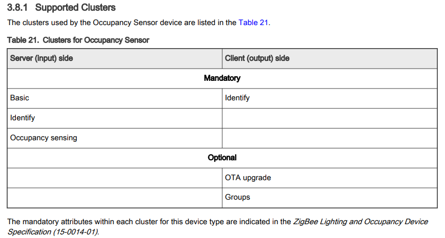

According to the JN-UG-3131 ZigBee 3 Devices (SDK folder > docs > wireless > Zigbee), these are the supported clusters for Occupancy Sensor device:

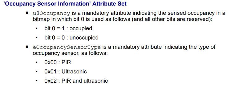

And, as you highlighted, the Occupancy Sensing cluster includes the following Attribute Set:
The Occupancy sensor device may only allow you to report an "occupied" or "unoccupied" state attribute.
If I am understanding correctly, you are trying to adjust the sensitivity level at which your device triggers the occupied state by writing to an attribute, is this correct?
Could you please provide more details about your sensor? Does your sensor allow you to get or set the sensitivity through software? If you need to add your own custom attribute and command to a cluster, please refer to JN-UG-3132 ZigBee3 Cluster Library, Appendix E.

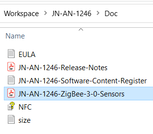

Just to confirm, are you using JN-AN-1246 ZigBee 3 Sensor Application Note as base for your development? Please, take a look at the JN-AN-1246 documentation contained inside Doc folder:
Here you can find more information on the implementation and usage of Light Sensor, Occupancy Sensor and LTO Sensor. Section 4.3 Using the OccupancySensor Application describes how to operate the Occupancy Sensor. The relevant value for this type of sensor should be u8Occupancy attribute, which reports an Unoccupied or Occupied sensing.
Eduardo.
