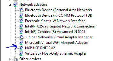

Using the USB-KW41Z board, I flashed it following the steps described in Instructions on how to use the USB-KW41Z Thread Border Router demo. I can now create a Thread network and connect other devices to it (here, FRDM-KW41Z boards). Ping between devices is OK.

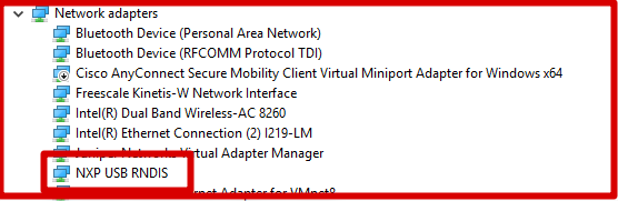

I am using windows 7. On the drivers side, I can see NXP USB RNDIS in the list of network adapters (Devices manager/Network adapters), so I assume I've got the right driver. I restarted my computer after a first installation to make sure the driver was recognized.
However, I have no network to connect to, nor any "FD01:" prefix to the hypothetic IPv6 address of my border router as described in the Demo Application User's Guide.
Did I forget a step ?
Thank you,
Sterenn

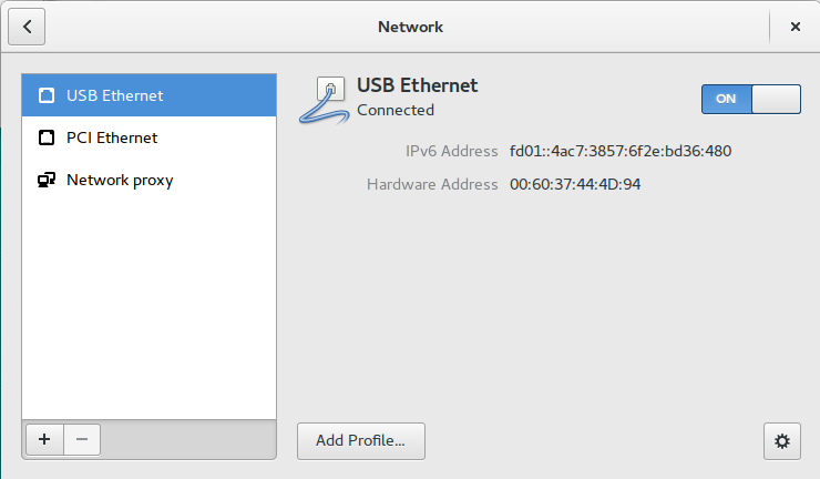

To get more information, I did look at the router through an Ubuntu virtual machine. There, the router is identified as "USB Ethernet" and has the right "fd01::" prefix address (attached screenshot). Still, I am able to ping the router from a terminal, but not to access the other Thread devices connected to the Thread network.
Any idea on how I could access the Thread network from here ?

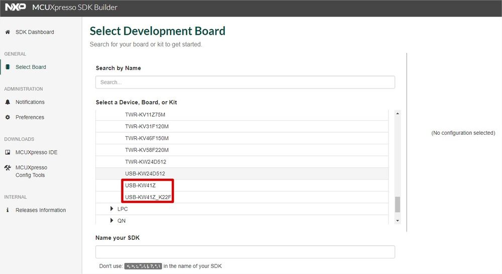

  1. Flashed the USB-KW41Z_K22F with the necessary software. One observation, I found the project border_router in USB-KW41Z SDK, built  and flashed it(on KW41Z chip, on J1). And in USB-KW41Z_K22F SDK I found a binary, placed here [...]\USB-KW41Z_K22F\tools\wireless\binaries\rndis_bridge_spi_slave_usbkw41z_k22f.bin. This binary was flashed with Test Tool. On the bar from upper screen select Firmware Loader, make sure you have the flash programmer connected to K22F (on J6). By the way, here you can find the last SDKs.

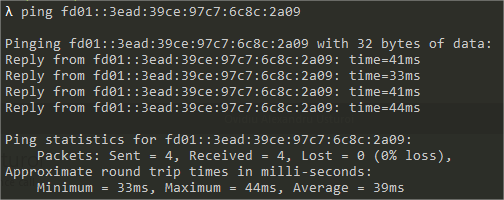

  4. Pinging from device to PC was possible, and vice versa.
    Make sure you are using the unique local address.
I didn't set any routes, it was automatically done when I installed the driver. I am using Windows 10. You can check to see if they are set. Also, make sure that you put down the addresses correctly. First time I tried it failed, and I saw that the address weren't copied correctly to clipboard, it trimmed me some characters.

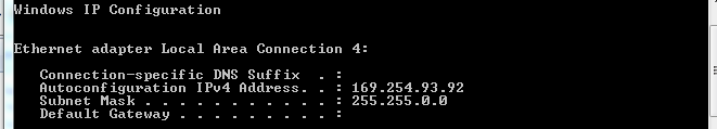

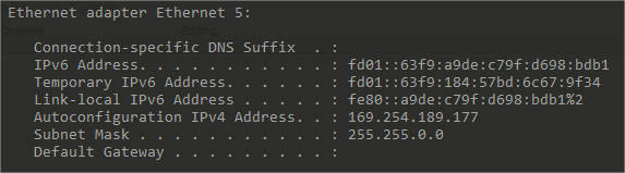

I followed these steps with the only difference that I used JFlash Lite to flash K22F. The RNDIS Network adapter shows up as expected :
After uninstalling and reinstalling the driver, the Ethernet configuration shows up in ipconfig : border_router_4.PNG
but as you can see there is no IPv6 configured : I am affraid this is due to a Group Policy of my company.

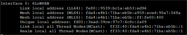

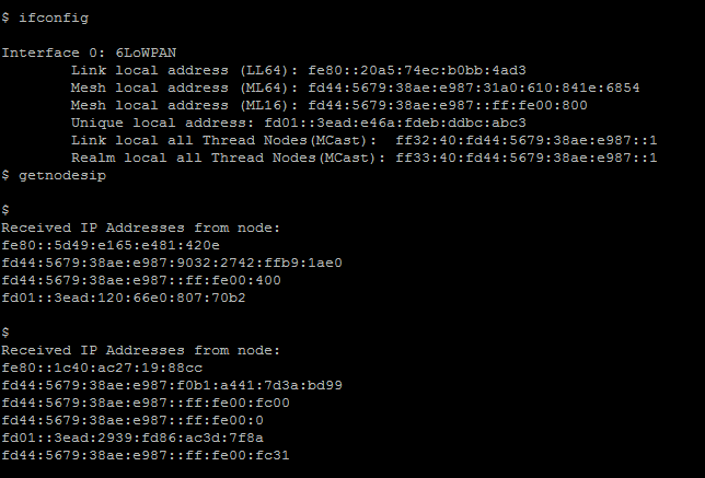

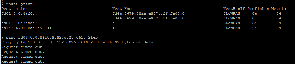

I connected the border router (short address 0x000), one host controlled device (short address 0x0400) and a thread router eligible end device (0x0800) to the thread network.
The interface configuration is the following :
(The border router is the second node).
  1. On the REED, I have the following routes :border_router_6_route.PNG
So we can see that we are routed to the border router through the Mesh network.
From the REED and Host controlled device, all the adresses (3 devices) from "getnodesip" can ping.
 2. On Windows, I had only IPv4 routes - as told before - and the interface was indeed enabled.
On the Pi (using Raspbian), the interface is enabled and has the following ipv6 addresses : fd01::84fo:whatever (global) and fe80::ff5:whatever (link)
Some routes are set, which give that the fd01:0:0:84f0:: and fe80:0:0:ff5:(full link address of the interface) go through eth1. No next hop is given.
3. Even when giving the interface -I eth1, we get either "network is unreachable" or "destination unreachable: address unreachable"

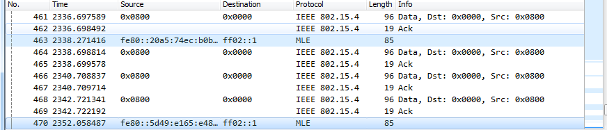

4. I have a second USB-KW41Z : the sniffer detects MLE and IEEE 802.15.4.
When REED pings eth1, it receives "Request timeout" while the sniffers identifies IEEE frames from the REED and to the REED (from Border router) containing "ACK" :
With this I feel we are really close from a result. If I get an ACK (so communication) on the MAC/PHY layer and not on the IP one, the problem should be in the configuration files (a misplaced macro) or indeed (thank you David for sharing) with a firewall or any other remaining security.
