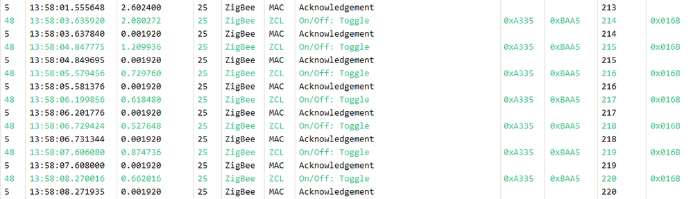

We used JN5169 to make a light control system,but now I found a problem, sometimes, the button can not control the light.Packet capture found that the button sent the command to the route, but the route did not forward the command to the light.
As the picture  shows,The button is 0xF60B,the route is 0xAE3D,the light is 0x6F6D.
Can you tell me what caused it,thank you!

For any reason, the Route 0xAE3D is not finding the light 0x6F6D. The route is not available, I am not sure if the 0x6F6D is not near from the Zigbee Network.
Is the 0x6F6D power on?

I submitted a new sniffer log,As the picture shows,The button is 0xA335,the route is 0xBAA5,the light is 0x016B.
The link Status show the  nighbor network of 0xBAA5 has 0x016B,but the 0xBAA5 did not forward the command to the 0x016B.
After the button is powered on and off again,it can forward the command to the 0x016B.
So Is it caused by a button or a route?What caused this?

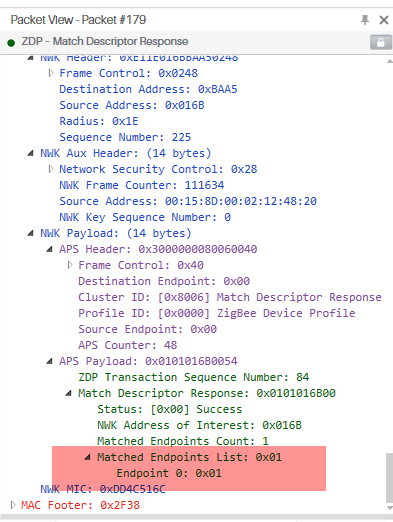

mario_castaneda
TC Trust Center.
The 0x016B device doesn't have any endpoint 1. What is the example that you programmed on this device?
What is the AN that you are working on these devices?

     Sorry for taking so long to reply to you.The equipment runs a modified program based on JN-AN-1217,We registered two endpoints, corresponding to two lights.Do you mean that the router cannot find the corresponding endpoint, so it cannot forward the message to the device?But why most of the time it can find the corresponding endpoint.
