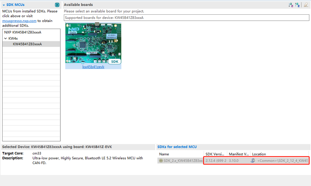

Can you please let me know your SDK version and which example are you using?
Where do you find this screenshot?
Christine.

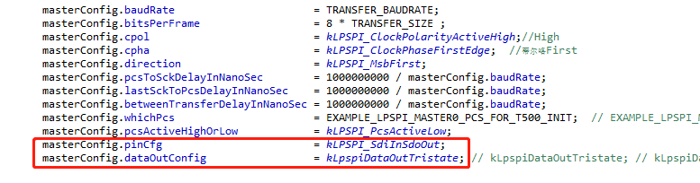

企业微信截图_16929439857935.png企业微信截图_16929439092241.png企业微信截图_16929437902677.pngThis is the code I ported from the official DEMO "freertos_lpspi", I use the routine "digital_key_car_anchor_freertos" this routine. We now use our own KW45 circuit board to debug the peripheral SPI chip, which must work in half-duplex mode. But we used this SPI code to debug with the slave, and the communication received data was wrong. When communicating with a full-duplex device, data is received and sent normally. Therefore, I would like to consult whether I need to modify the underlying configuration of SPI in half-duplex dual-mode.

Can you please check whether the Master side has masked tx data in half duplex mode(fsl_lpspi.c) and debug according to the configurations in KW45B41Z83.h
LPSPI_MasterTransferNonBlocking() and  LPSPI_MasterTransferBlocking() function.
/* Mask tx data in half duplex mode */
if (((temp == LPSPI_CFGR1_PINCFG(kLPSPI_SdiInSdiOut)) || (temp == LPSPI_CFGR1_PINCFG(kLPSPI_SdoInSdoOut))) &&
(transfer->txData == NULL))
stateParams.isTxMask = true;
/* Mask tx data in half duplex mode since the tx/rx share the same pin, so that the data received from slave is not
* interfered. */
(handle->txData == NULL))
handle->isTxMask = true;
#define LPSPI_CFGR1_PINCFG_SHIFT (24U)
/*! PINCFG - Pin Configuration
* 0b00..SIN is used for input data; SOUT is used for output data.
* 0b01..SIN is used for both input and output data. Only half-duplex serial transfers are supported.
* 0b10..SOUT is used for both input and output data. Only half-duplex serial transfers are supported.
* 0b11..SOUT is used for input data; SIN is used for output data.
Christine.
