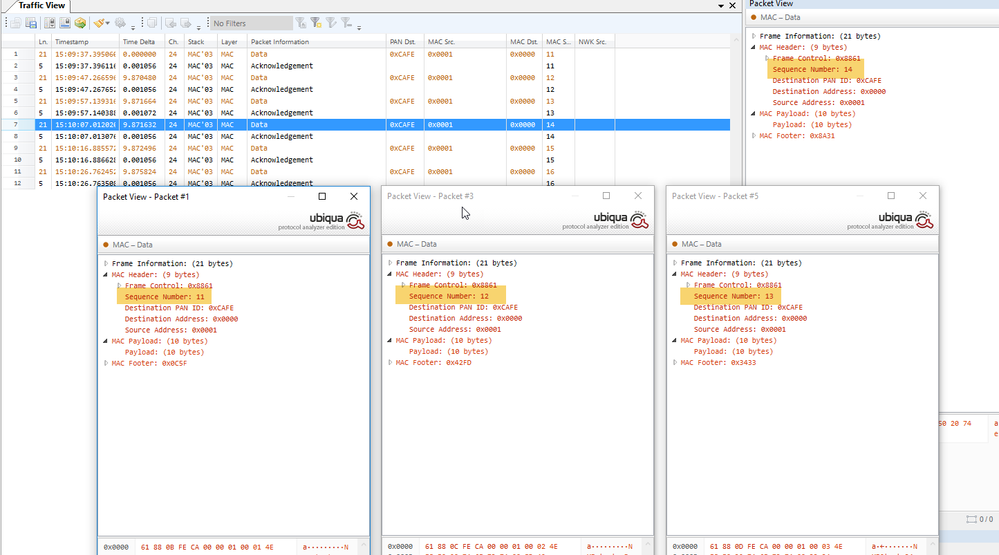

I am using  vAppApiSaveMacSettings() before vAHI_Sleep(E_AHI_SLEEP_OSCON_RAMON) and vAppApiRestoreMacSettings() when AppWarmStart().
My problem is the following.
The mac seq number is always same if it transmits by vAppApiMcpsRequest() when sleepy device was woken from sleep mode .
That mac seq is 76.
But When none sleep, it's normally increase by one.
The attachment is sniffer log.

mario_castaneda
Hi Lee,
Please print the pu8Payload[0]  value before you go to sleep. The sEndDeviceData.u8TxPacketSeqNb++ is increasing the sequence number.

mario_castaneda
Hi Lee,
You must modify the MAC_Pib_s structure before sending the data.
    uint8                       u8Dsn;/**< macDSN attribute */
} MAC_Pib_s;
mac_pib_CombinedMac.h
s_psMacPib->u8Dsn= count++;‍‍‍‍‍‍‍‍‍‍
Let me know your findings.
Mario

wslee
Hi Mario,
Thanks for your response.
I have tested, but the result is same. This mac seq is always 76.
The following is source code.

mario_castaneda
Hi Lee,
You should add the code out of the vTransmitDataPacket and before of it.
 vTransmitDataPacket(&TxData,9,TagVstemp.u16coordShortAdr);
Please let me know your findings.
Mario

mario_castaneda
Hi Lee Wonsoo,
How are you implementing the sleep mode?
 PRIVATE MAC_Pib_s *s_psMacPib;
 while (1)
        vProcessEventQueues();
        if(sEndDeviceData.eState == E_STATE_ASSOCIATED)
           DBG_vPrintf(TRUE,"s_psMacPib->u8Dsn 0%0d;\n",s_psMacPib->u8Dsn);
        if(sEndDeviceData.eState == E_STATE_TX_END)
Mario

wslee
Hi Mario.
I found the Issues in Makefile.
Before
CFLAGS += -DENABLE_OPT_IN_MAKE
CFLAGS += -DENABLE_OPT_RFD
After
#CFLAGS += -DENABLE_OPT_IN_MAKE
#CFLAGS += -DENABLE_OPT_RFD
I have changed for sleepy device but It was the wrong setting.
Thank you for your support.
