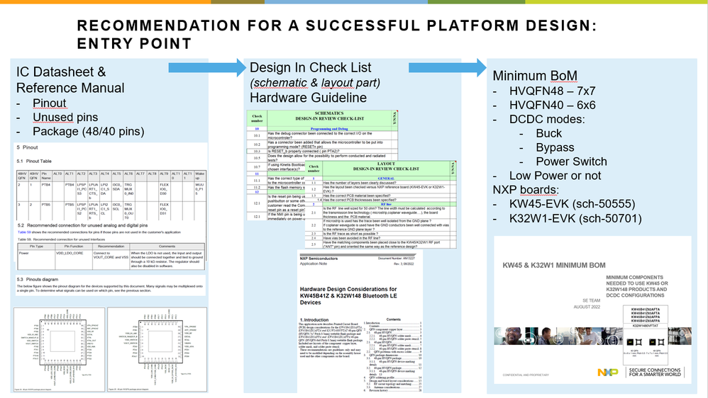

Please, find the important link to build a PCB using a KW45 or K32W1 & MCX W71 and all concerning the radio performances, low power and radio certification (CE/FCC/IC).
KW45 product NXP web page:
https://www.nxp.com/products/wireless/bluetooth-low-energy/32-bit-bluetooth-5-3-long-range-mcus-with...
K32W1 product NXP web page:
https://www.nxp.com/products/wireless/multiprotocol-mcus/tri-core-secure-and-ultra-low-power-mcu-for...
MCX W71 product NXP web page:
https://www.nxp.com/products/processors-and-microcontrollers/arm-microcontrollers/general-purpose-mc...
KW45-EVK getting started NXP web page:
https://www.nxp.com/products/processors-and-microcontrollers/kw45b41z-evaluation-kit-with-bluetooth-...
https://www.nxp.com/document/guide/getting-started-with-the-kw45b41z-evaluation-kit:GS-KW45B41ZEVK
K32W1-EVK getting started NXP web page:
https://www.nxp.com/products/processors-and-microcontrollers/k32w148-evaluation-kit-with-multiprotoc...
https://www.nxp.com/document/guide/getting-started-with-the-k32w148-development-platform:GS-K32W148E...
FRDM-MCXW71 / MCXW71-EVK getting started NXP web page:
https://www.nxp.com/document/guide/getting-started-with-frdm-mcxw71:GS-FRDM-MCXW71
HARDWARE
    KW45-EVK HW guideline: Hardware Design Considerations for KW45B41Z and K32W148 Bluetooth LE Devices (nxp.com)
    MCXW W71 HW guideline: MCXW71 Hardware Design Guide
    KW45B41Z-EVK User Manual https://www.nxp.com/docs/en/user-manual/KW45B41Z-EVKUM.pdf
    K32W1-EVK User Manual: K32W148-EVK Board User Manual (nxp.com)
    FRDM-MCXW71 USer Manual: FRDM-MCXW71 Board User Manual
     Minimum BoM (attached file)
    DCDC management guide (AN13831): 'NXP account required to access this content KW45/K32W148 - Power Management Hardware[AN13831]' from https://www.nxp.com/products/KW45
    Migration guide: KW38 to KW45: Available on demand
    Design-In check list: excel file attached
    RF matching: S parameters (attached file)

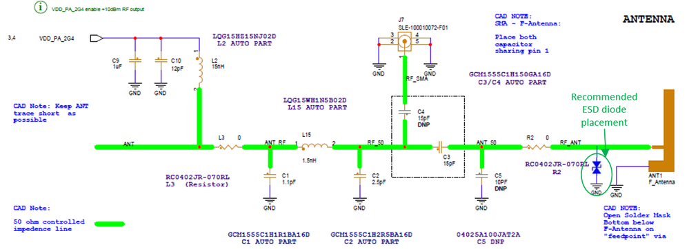

    ESD: Please note as raised in the KW45 datasheet, the ElectroStatic Discharge of the RF antenna pin is +/-250V (change-device model). In case the targeted system need to pass larger ESD target then an external ESD diode is recommended. The following reference are foressen as acceptable : Nexperia PESD5V0C1BLS-Q, littlefuse SP3522-01ETG, SPSEMI AUSD05CBL.
IMPORTANT Information; launch prototype before production platform to fine tune RF path:
“As RF behavior are dependent of PCB layout & manufacturing; PCB prototypes (based on NXP recommendations) will have to be fine-tuned to insure the expected qualified in RF is reached on the final productized platform.”

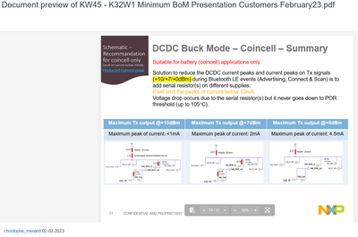

Does anyone help me to about the value of power consumption for KW54 in three modes( PMIC, DCDC, Bypass) ?
23,220件の閲覧回数
christophe_menard
Hi Suleymansekerci,
Could you precise your request about the three modes( PMIC, DCDC, Bypass), please?
For your help, you could refer to the AN13230 Kinetis KW45 & K32W1 Bluetooth LE Power Consumption Analysis available in NXP site and playing with the KW45_BLE_power_profile_calculator_v1.5.xlsx file.
For your guidance, the most safe power is the buck mode (DCDC inside the Kinetis product)  for sure without any extra BoM cost.

marko_pavlin
Hi, I am looking the "minimum BOM" document. At the end, there is a table with con-cell operation recommendation:
Is this OK? 10dBm <1mA, ... 0dBm : 4,5mA ?
