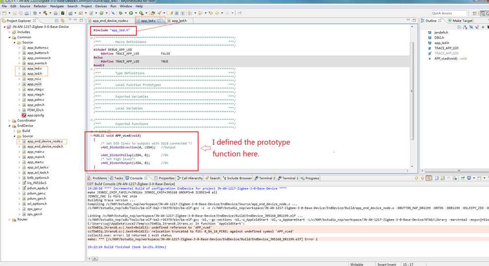

I added a function, but there are some trobles in compile.
Please give me some help.
Thanks very much.

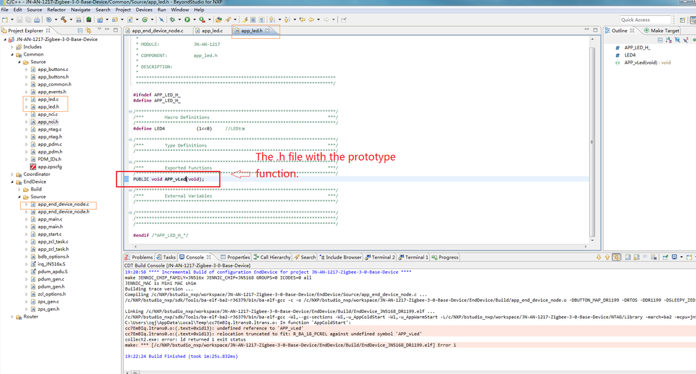

mario_castaneda
Hi Zhang,
Did you define the prototype function? as you can see, both c files should have a .h file with the prototype function.
Mario

quanjunzhang
Hi Mario,
I had defined the prototype function. And the c file  has a .h file with the prototype function.
Below is my screenshot. Can you help me check it?
thank you very much. I have spent a lot of time.
Zhang

mario_castaneda
Hi Zhang,
Be sure that the prototype function that you are using is defined as extern.
Mario

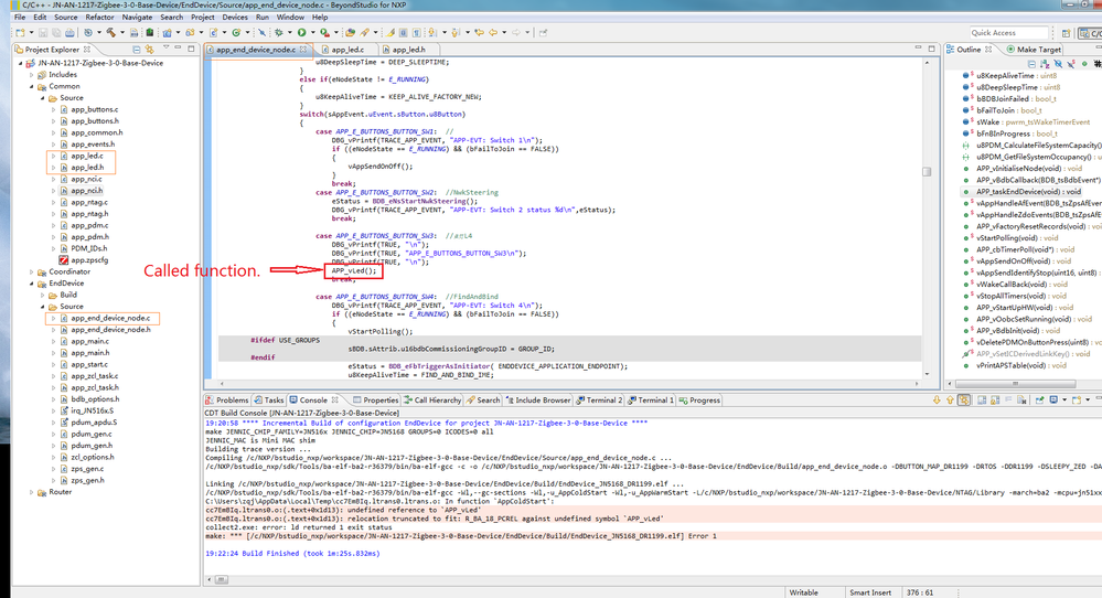

quanjunzhang
Hi Mario,
I just created the app_led.c and app_led.h files and define a function under the new folder, then called the function in app_main.c. This will cause a compilation error.
BUT, if I define the same function under the existing folder (app_end_device_node.c), then called the function in app_main.c. This will be no error.
Is this because the .c.h file I created requires additional system configuration?
Please give me some accurate advice, I have spent too much time to solve this problem, thank you very much.

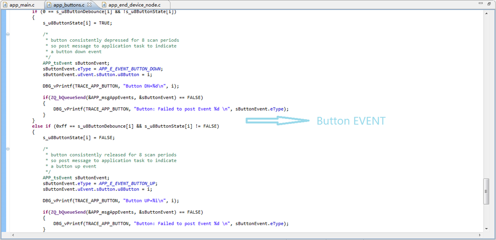

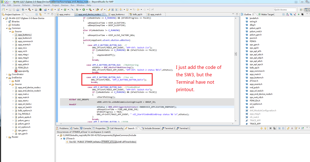

mario_castaneda
Hi Zhang,
Did you create an event for the button 3?
Did you set up the DIO as an input?
Mario
5,397 Views
quanjunzhang
It is OK now.
The application notes has set the  DIO as an input and  created an event for the button 3.
