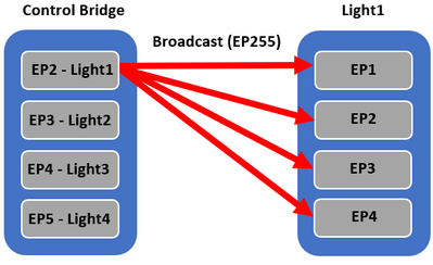

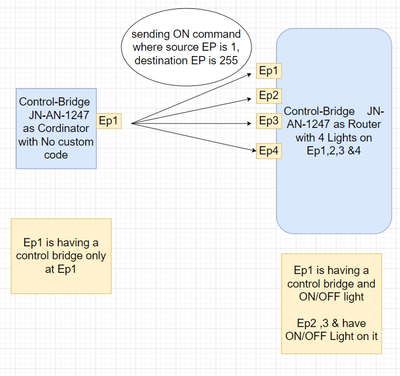

I am adding few more endoints to the JN-AN-1247 Control bridge for zigbee 3.0 based on JN5189.
I am adding ON/OFF Light on the three endpoints 2,3,4 , keeping the 1st endpoint as control bridge.
I would be using the control bridge as a Full_Function_Router device.
Everything so far is OK except that when I send any command using group id or  Broadcast EP 255  the Endpoint above 2 doesnt recieve it!
So an ON command to EP 255  will result in switiing ON on Ep 1and 2 but not on 3 or 4. Strangely when sent to EP 3 or 4 it will switch on the relevant Light. I am not sure where is the issue and how to get its cause.

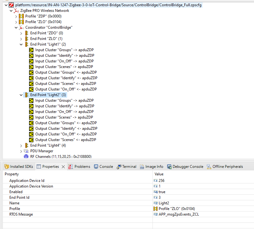

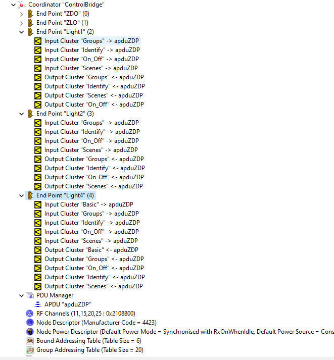

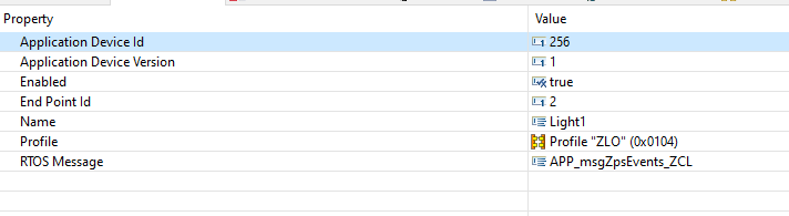

What I have done so far
  1. Took AN-JN-1247 as initial device
  2. Configured the ControlBridge_Full.zpscfg to add the new endpoints with input and output clutsres as below
  3. Modified the Zcl_options.h to reflect the above

Just to confirm, are you trying to perform a broadcast from one end point (Control Bridge) to several On/Off compatible devices (Lights)?
Could you please confirm that you have read [JN-UG-3131-ZigBee3-Devices] Section 1.4 Device Initialisation and Chapter 3 Lighting and Occupancy Device Types, Section 3.1 On/Off Light?
Also, could you please share your Light End Point properties?
Eduardo.
12,016件の閲覧回数
dmsherazi
Thanks for your response @EduardoZamora
No. Sending to short/Nw address but selecting 255 as EP wont send command to the Light at EP 3 & 4. Ep 1 and 2 will recieve the command. When sending command to EP 3 and 4 by using destination EP as 3 or 4 will work.
Also when sending a command to group address. 3 & 4 wont get the command!
>>  Properties of ENDPOINTS
I am attaching the project files for you to check them. I am using the Full Fuction device Without GP  ControlBridge_Full.zpscfg

The situation is like this . I have two devices . One loaded with ControlBridge App Note without modifications. This acts as cordinator as well as control bridge.
The second One has been modified in the sense that 4 ON/OFF Lights are added to it. One Light is added on Ep1 which has the controlbridge as well. and other lights are on Ep 2 , 3 and 4. This device is set to work as Router Control Bridge.
Situation is like this. When I send any command to the Second CB from the first where destination EP is 255 , ideally All Four Lights should get the command and execute but only EP1 and Ep2 gets it. It should be noted that when I send the same comamnd to each endpoint individually the commands are recived.
Further more its worth mentioning that sending the command to broadcast endpoit on any other 3 or 4 gun light will work as expected

For development purposes I am using the ZGWUI for both the controlbridge and the router with lights.
I have  recorded a screencast showing the scenario.
The issue in short is that all endpoints (1,2,3&4) responds when I send command to a specified endpoint (where destination endpoint is 1,2,3 or 4). but when the destination endpoint is 255 (0xFF) in the command then only endpoint 1 and 2 will get that and not 3 & 4.

Could you please try adding Basic cluster to the Light End Points? This cluster is mandatory for all ZigBee devices [JN-UG-3132 ZigBee3 Cluster Library, Chapter 8 Basic Cluster].
You can find mandatory clusters for each End Point in SDK folder > docs > wireless > Zigbee > JN-UG-3131 ZigBee3 Devices, Chapter 3 Lighting and Occupancy Device Types.
Eduardo.
11,868件の閲覧回数
dmsherazi
I already added it , and its the same - No improvemnets. Can you explain how the broadcast endpoint is handled at the stack level?
