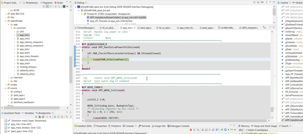

I have the problem that the device doesn't go to the power down mode, as expected.
If I set a breakpoint in the function APP_HandleLowPowerOnIdle() in app_init.c I can see, that the low power mode is never activated by calling the PWR_EnterLowPower(). I think the reason is, that the bSleepAllowed variable is set to FALSE and is not set back to TRUE.
I searched for the functions, that act with the bSleepAllowed variable which are App_AllowDeviceToSleep() and App_DisallowDeviceToSleep(). There is no call of these functions, but the initial state of bSleepAllowed is changed and the power down mode is never activated.
Has anybody sucessfully used the lped_bm example with the power down mode?

Hope you are doing well. The APP_HandleLowPowerOnIdle function checks if the device can go to sleep, to enter the low power mode.
In the main_task function, the PWR_DisallowDeviceToSleep function is called, so the PWR_AllowDeviceToSleep function must be called to allow to enter sleep mode, and this function is called in the Stack_to_APP_Handler (case OT_DEVICE_ROLE_CHILD).
I have tried with reed_bm example on a K32W and the lped_bm example on another K32W, and I can get into this Low Power Mode.
Could you please check if the PWR_AllowDeviceToSleep function is called?
Ricardo
2,576 Views
Micha1
Hi Ricardo,
I checked the calling of the PWR_AllowDeviceToSleep funktion. It is called as expected and the function PWR_CheckIfDeviceCanGoToSleep() is returning True. So the Problem is the bSleepAllowed flag, which is set to False. If I comment out the bSleepAllowed flag, the sleep is called.
