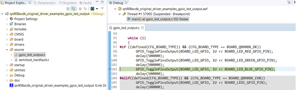

I imported the attached project to my MCUXpresso installation and unfortunately I still wasn't able to replicate the issue:
Could you please let me know if your customer is using our QN9080-DK board or if they are using a custom board?
Sebastian
