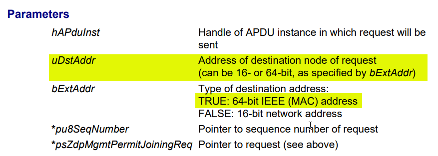

You could send the permit to join with the ZPS_eAplZdpMgmtPermitJoiningRequest in the coordinator, but the short address will be the short address of the Router.
 return ZPS_eAplZdpMgmtPermitJoiningRequest ( hAPduInst,
                                                0XA085,//Router address
                                                FALSE,//FALSE: 16-bit network address
                                                pu8Seq,
                                                &sAplZdpMgmtPermitJoiningReq );

mario_castaneda
Hi Gianm
You could also send the ZPS_eAplZdpMgmtPermitJoiningRequest using the Mac address.
https://www.nxp.com/docs/en/user-guide/JN-UG-3101.pdf
Mario
