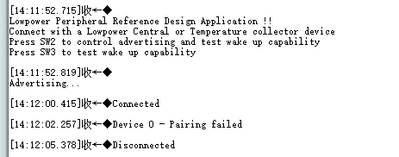

      I used the EVK development board to download the DEMO program, but the connection Bluetooth prompt pairing, I use the mobile phone to click the pairing prompt failed. Please tell me how I should operate this pairing in order to succeed. And what if I cancel the pairing first?
DEMO: kw45b41zevk_lowpower_peripheral_freertos

Ricardo_Zamora
As you are using the Low-power peripheral, please help me checking the "KW45_K32W1_Low_Power_Connectivity_Refernce_Design_User_guide.pdf" (Path: SDK_KW45B41Z-EVK.zip\docs\wireless\Common).
Hope this helps!
