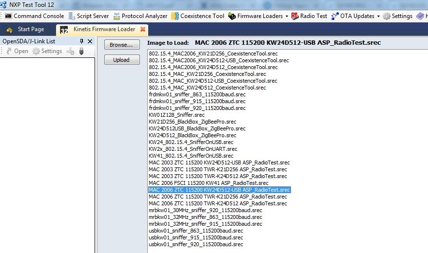

It is also not clear to use which*.srec file for Radio testing. I tried "MAC 2006 ZTC 115200 KW24D512-USB ASP_Radiotest.srec (as shown below). But I still dont see any signal at the  SMA connector of Freedom Board.

It is not possible see the file, could you please try again.?
If you want to make a Radio testing, you can check the next link, the option build and run.

I highlight the firmware which I used to do Radio Testing. What could be the problem?
I dont understand which link you mean?

Could you please check the next document?, Quick Start, USB-KW24D512
http://www.nxp.com/files/32bit/doc/user_guide/USBKW24D512QSG.pdf?fsrch=1&sr=6&pageNum=1
Let me know, if you upload another example and the problem is the same
