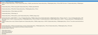

Errors out of the box:
led_blinky.out
.postbuild
FAILED: C:/sandboxes/nxpexample/beacon9090_sdk265_blinky3/led_blinky/debug/.postbuild
cmd /C cd C:\sandboxes\nxpexample\beacon9090_sdk265_blinky3\led_blinky && C:\sandboxes\nxpexample\beacon9090_sdk265_blinky3\led_blinky/dk6_iarpostbuild.bat C:\sandboxes\nxpexample\beacon9090_sdk265_blinky3\led_blinky\debug\led_blinky.out 294912 && echo > "C:\sandboxes\nxpexample\beacon9090_sdk265_blinky3\led_blinky\debug/.postbuild"
C:\sandboxes\nxpexample\beacon9090_sdk265_blinky3\led_blinky>set script_path=C:\sandboxes\nxpexample\beacon9090_sdk265_blinky3\led_blinky/dk6_iarpostbuild.bat
C:\sandboxes\nxpexample\beacon9090_sdk265_blinky3\led_blinky>set file=C:\sandboxes\nxpexample\beacon9090_sdk265_blinky3\led_blinky\debug\led_blinky.out
C:\sandboxes\nxpexample\beacon9090_sdk265_blinky3\led_blinky>set stated_size=294912
C:\sandboxes\nxpexample\beacon9090_sdk265_blinky3\led_blinky>set app_id=
C:\sandboxes\nxpexample\beacon9090_sdk265_blinky3\led_blinky>set python_script=C:\sandboxes\nxpexample\beacon9090_sdk265_blinky3\led_blinky/dk6_image_tool.py
C:\sandboxes\nxpexample\beacon9090_sdk265_blinky3\led_blinky>if "294912" == "" (py -3 C:\sandboxes\nxpexample\beacon9090_sdk265_blinky3\led_blinky/dk6_image_tool.py C:\sandboxes\nxpexample\beacon9090_sdk265_blinky3\led_blinky\debug\led_blinky.out ) else (if "" == "" (py -3 C:\sandboxes\nxpexample\beacon9090_sdk265_blinky3\led_blinky/dk6_image_tool.py -s 294912 C:\sandboxes\nxpexample\beacon9090_sdk265_blinky3\led_blinky\debug\led_blinky.out ) else (py -3 C:\sandboxes\nxpexample\beacon9090_sdk265_blinky3\led_blinky/dk6_image_tool.py -s 294912 -i C:\sandboxes\nxpexample\beacon9090_sdk265_blinky3\led_blinky\debug\led_blinky.out ) )
Unable to create process using 'C:\Python312\python.exe C:\sandboxes\nxpexample\beacon9090_sdk265_blinky3\led_blinky/dk6_image_tool.py -s 294912 C:\sandboxes\nxpexample\beacon9090_sdk265_blinky3\led_blinky\debug\led_blinky.out': The system cannot find the file specified.
C:\sandboxes\nxpexample\beacon9090_sdk265_blinky3\led_blinky>arm-none-eabi-objcopy -O binary C:\sandboxes\nxpexample\beacon9090_sdk265_blinky3\led_blinky\debug\led_blinky.out C:\sandboxes\nxpexample\beacon9090_sdk265_blinky3\led_blinky\debug\led_blinky.out.bin
'arm-none-eabi-objcopy' is not recognized as an internal or external command,
operable program or batch file.
Total number of errors: 1
Total number of warnings: 0
Resolving dependencies...
Build failed
After removing post Build action it compiles.

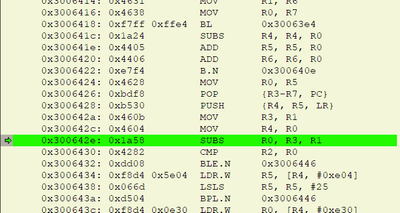

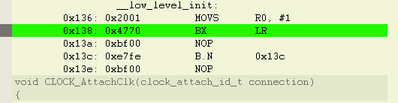

But doesn't get to main in IAR 9.2
It's just wonders around in:
Why is that?

It finally gets to main
but debugging dies in
BOARD_BootClockRUN();
     -> CLOCK_AttachClk(kFRO12M_to_MAIN_CLK);
If I step on Disassembly view then it gets over it.

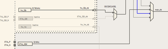

I have 32Mhz selected in GUI

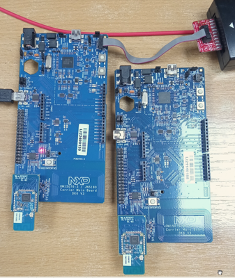

Same issue with two devkits. And this is only a blinky.

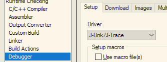

I'm using Jlink Plus debugger, never had problems with it on STM32.

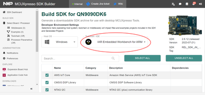

Hi @arpad_toth ,
Hope you are doing well!
MCUXpresso SDK Builder provided a IAR toolchain option for QN9090DK6. Would you please have a try with it?

I always have IAR version selected,
I tried the latest version
and generated a blinky again from it, ran it on IAR 8.32.1, and it doesn't even stop at main( )
I just wonders around at:
Does the previous example I attached  work for you?

We believe that there is a misunderstanding on the SDK and Config Tool.
On the web MCUXpress SDK Builder, we can find some boards' SDKs support different IDE Tool Chains, such as MCUXpresso IDE, IAR, and Keil.
If it meet our requirements, we can just build and download the corresponding one. Then we can use it directly in IDE with out Config Tool converting. But if you want to use IAR while the SDK Builder only provided MCUXpresso IDE version, and in this scenario, we can then use the Config Tool to make the conversion. (SDK MCUXpresso to SDK IAR)
For your use case, there is no need to use the config tool again for conversion.
I tried on my side with the  IAR Version SDK directly, it works well. And also, I downloaded a MCUXpresso Version SDK and converted with Config Tool to IAR Version SDK, it is ok.

IAR doesn't seem to find the main function unless I step it in assembly.

If I turn optimalization from Low to None then it finds main().
But still gets stuck at
BOARD_BootClockRUN()::CLOCK_AttachClk(kFRO12M_to_MAIN_CLK);
so still no blinking.
I think there is a problem with startup code or HAL maybe.

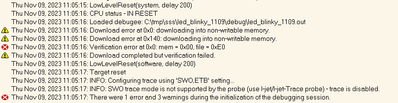

Your project in IAR 9.40.2
Fails the same way with Jlink, it wonders around instead of break on main()
BUT it stops correctly at main with CMSIS DAP!
Although it still has verification error:
AND only stops at 2nd attempt of running after programming.
    (first time it seems to wonder in RAM, not in flash!)
And after that I let it go and see blinking!
Very weird, please see the video
https://youtu.be/iOjWRgYwe8E
My Blinky fails with both JLINK, and CMSIS DAP debugger.

you shouldn't get a verification error,
it should stop at main on first attempt,
and it should blink after you let it go.
