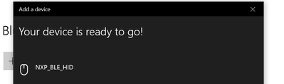

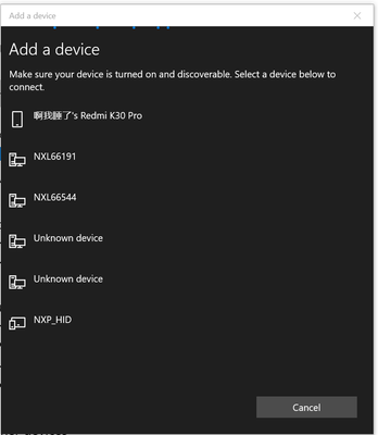

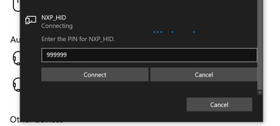

For your requirements, please refer to this guide "Bluetooth® Low Energy Demo Applications
User’s Guide", you can find it at this path: SDK_2_6_205_QN9090DK6\docs\wireless\Bluetooth\Bluetooth Low Energy Demo Applications User's Guide.pdf
scan_result_onPC.pngScreenshot_2023_04_27_11_01_13.pngScreenshot_2023_04_27_11_01_42.png
The section 5.6 HID Device (Mouse) explains in detail how to use this project. And please notice:
  1. When you flash the board with this project, the board begins in idle mode, to start advising, you should press the "USER INTERFACE" switch on the board.
  2. Then use you PC Bluetooth scanning devices and you will find this name "NXP_HID".
  3. Click connect on the PC UI, then enter the Pin "999999".
  4. It will connect well, and the mouse will draw a square itself without your move.
