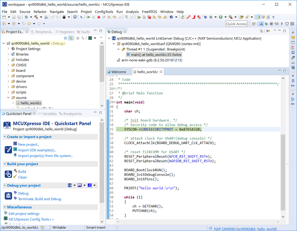

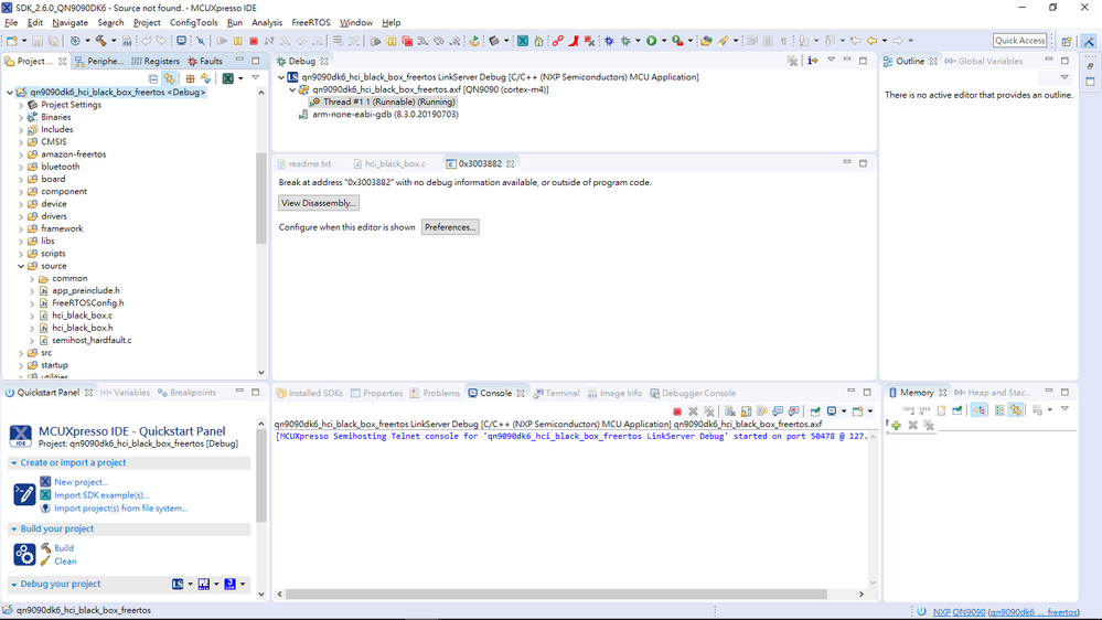

   I get QN9090-DK006 and download "SDK_2.6.0_QN9090DK6" to import into MCUXpresso.
But after I build one project to into debug mode to get below status.
it don't from main() like user guide
That Debugger console show below message.

Program stopped.
0x03003882 in ?? ()
Note: automatically using hardware breakpoints for read-only addresses.
What issue occur "Program stopped 0x03009882 in ??()"

ethanchen
Hi Estephania,
Thanks your reply.
You are right, My MCUXpresso is latest of v11.1.0_3209.
That release note description is use v11.0.1. So can't it use latest MCUXpresso?
After try importing the project using UART instead of semi hosting that result is same with v11.1.0

estephania_mart
Could you please help me confirm that you followed all the steps mentioned here?
Getting Started with QN9090 | NXP

ethanchen
Hi Estephania,
Thanks your link that is useful.
I think that maybe key issue with install Python 2.7 portion that user's guide not clear in Windows system environment variables. Before to perform pip install pycryptodome is fail.
After check your video to perform it is workable.
Now I can run debug from main code.
Thanks your great support. If any question will dicuss with you again.
