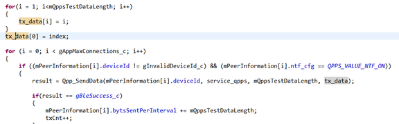

I try to do data transmission through QN9080cdk using SDK example in MCUxpresso: "qn908xcdk_wireless_examples_bluetooth_private_profile_server_bm". I works fine, and USB dongle get data well. Now I want to change the sending data to in my PC file.
Default in SDK: tx_data[]

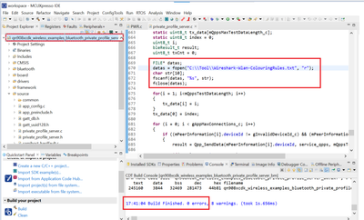

Now I want to read ".txt" or ".csv" file in my PC and send it wirelessly. So, I try to use fscanf() function in <stdio.h> or <stdlib.h>but it does not work. (of course I #include .h file)

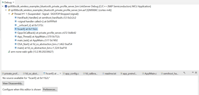

The error message is below...
I check that fopen() and fclose() works fine, only fscanf() makes that problem. Almost similar function like fgets(), fprintf(), fputs(), etc... are all not working. What is the problem? Is it really a semihosting problem? How can I solve this problem or is there any other way to read or write files in my PC through MCUxpresso and send it wirelessly?

Do you mean when you build with the code you are showing in screenshot, it will show these errors?
I also tried on my side with IDE 11.9.0 and SDK_2_2_9_QN908XCDK, it can build successfully.
Can you please with same SDK and IDE with mine and let me know your results?

My one is MCUXpressoIDE_11.9.0_2144 and SDK_2_2_9_QN908XCDK which is same as you.
Of course building is done well in my IDE. But if I actually want to send it wirelessly, I have to debug it. And when directly after connectivity QTool or loT toolbox actually starts receiving the data, the error happens.

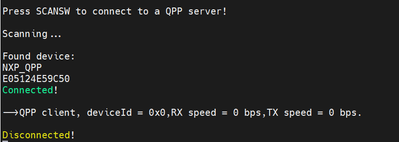

And after I add the part you shared, I can compile successfully, flash successfully, but when it trying to connect with client, the client terminal will show disconnected automatically in several seconds like below:
And also in my MCUXpresso, show same with you.
I am trying to find the root cause and trying to resolve this issue.
