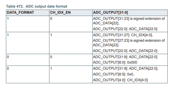

FelipeGarcia
Hi Arpad,
As you mentioned it's not possible to change the format in the ADC. The user manual gives you the following formats:
However, if you check the user guide in chapter 30.2 it says the ADC is a 16-bit sigma-delta ADC.
Which means the ADC resolution is already 16 bits.
QN908x user manual
Felipe.

arpad_toth
Hi Felipe,
Yes it is a 16bit ADC, but the output is represented as 23-bit signed fractional data, so for 0V input I would get weird big signed numbers 0x123456.
Do you have an example C code how to convert it back to unsigned 16bit?
Arpad
2,294 Views

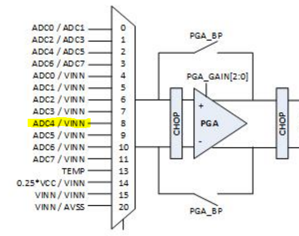

FelipeGarcia
Hi Arpad,
Unfortunately you cannot get a 16 bits unsigned value cause this ADC is a differential sigma-delta ADC. This means that for single-ended usage, the analog input is connected to the positive end, while the negative end input is connected to an internal generated voltage, VINN.
However, you can approximate to that behavior if you shift the g_AdcConvResult register as follows:
result_16bits = (g_AdcConvResult >> 16);
By doing this you will be able to get a value from -32768 to 32767.
Finally, you should change the VINN value to 0 if you want only positive numbers. This is possible if you configure the ADC as follows:
Felipe.
