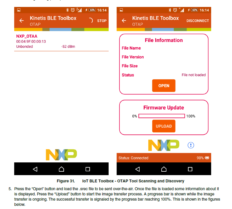

Dear Sir
           I can’t see NXP_OTAA in IOT Tool box after I follow API Guide based on newest QN9080 SDK.
           Could you try it in your side and make sure if NXP_OTAA can show in the app?

Just to make sure I fully understand you.
You used the OTA, flashed a new firmware, and you can't perform the OTA again? If you flashed a new firmware, I believe that was an example, do you see the example functionality in the application?
I mean, if you loaded a heart rate sensor, do you see it in the app?

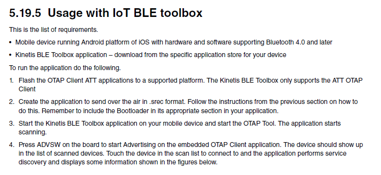

hello, i test otap in qn9080 board,with client att code, after programing first time when i update using otap ,code uplode and work properly. but second time it not update it restart from 1% again and again
5,591 次查看
jasonchiang
You said "second time it not update it restart from 1% again and again". Could you make sure if you still see OTAP_Client_ATT after you performed 1st OTAP ? I think it already been flashed update by your application.
You need to integrate OPTA_Client_ATT with your application first, then perform OTAP. After that, you may can perform 2nd OTAP process.

Simple to say : we haven't default code for the requirement of " performing 2nd OTAP ". What profile you used in your application ?  You need to integrate OTAP_ATT_Client project file into your profile code for your application running 2nd OTAP. Hoping this explain it.
