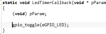

I've set up a test that sets up an LP timer that toggles an led at 10Hz.  BLE is disabled and all other tasks are shut down.
Callback:

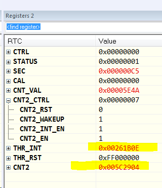

The freerun timer is enabled and the interrupt and wakeup bits are set:

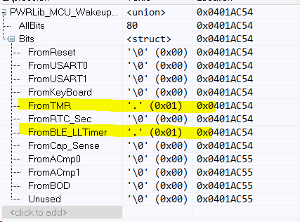

After a wakeup event, the reason correctly identifies that a TMR event occurred:
But the wakeup is actually coming from the BLE_LLTimer and not the TMR.  The MCU wakes up roughly every 10s and not 100ms as expected.

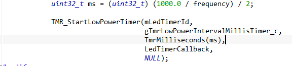

I've narrowed down the problem using only demo code so hopefully someone at NXP can shed some light.  This test uses the power_profiling sample project and a QN9080-DK 1.2 board.
I created a low power millisecond interval timer with a 200ms interval.  The timer callback toggles the blue LED. The timer is started when the button is pressed so that PD0 is active.  I bumped the number of timers in app_config.h to make sure I wasn't running out of them.
I expect the MCU to go into PD0 and wake up periodically to toggle the LED.  This does not happen.  The MCU goes into power down and stays there, even with the debugger connected.
My changes to power_profiling.c:

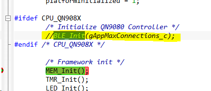

joseraffucci
The timer works as I expect it to when I disable the BLE stack initialization.  LED blinks and I can see that the MCU is going in and out of DS mode.  Unfortunately BLE_Init() is behind the library interface and I can't debug any further.
Can you kick this back to your developers?  I need a workaround soon.

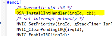

joseraffucci
I found an answer to one of my questions.  The MCU gets lost when I don't define the handler because the ram and flash vectors are getting mixed up.
The examples do in fact set up RTC_FR_IRQHandler  because of a bug in the SDK.

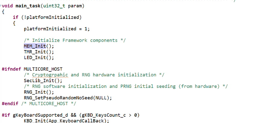

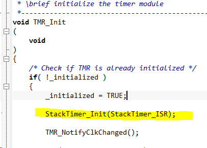

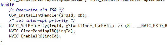

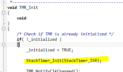

When the system is coming up, the timers are initialized in TMR_Init():
 StackTimer_Init() overrides and enables the RTC_FR interrupt so that the stack timer handler is used:

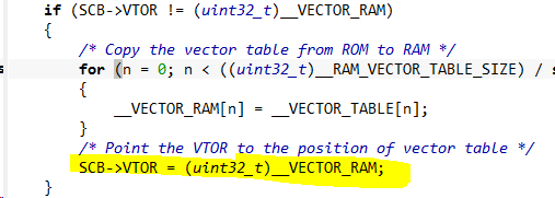

The abstraction layer eventually calls InstallIRQHandler where the new handler is installed.  Note that the vector table is then moved to RAM:

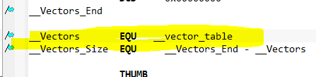

After initialization, I eventually go into DS(0) in POWER_EnterPowerDown().  On my very first wakeup event,  the vector table pointer is restored  to _Vectors:
Unfortunately, you can see that in startup_QN908XC.s _Vectors is defined as the flash vector table.
...oops!

joseraffucci
One more data point for today...
I have found that I do in fact get FR interrupts.  They're just not getting handled the way I expect.
In TMR_Init, a call is made ot StackTimer_Init which should override the vector for FR interrupts.
StackTimer_Init:

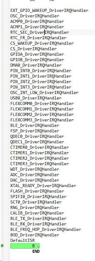

On a hunch, I created a default handler:
And found that after a wakeup from DS, it gets called!  It is not getting overwritten by StackTimer_ISR.
And when I don't create the default handler, the MCU doesn't know who to call after a wakeup!
The RTC FR count is well above the threshold so it's clearly not responding to that as a wakeup trigger.
So I'm left with 2 slightly more specific questions:
1.  Why on earth is my interrupt vector getting trashed when I wake up from DS?
2.  Why is the FR interrupt not waking up the MCU?  (see previous posts for RTC config, I believe it's set up correctly).
