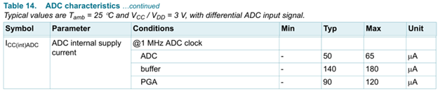

2. BLE will work in deep sleep mode, and power consumption is about 2uA, if connnect ADC to Vbat, and do not open the battery monitor function, whether it will add power consumption? What is the power consumption for the ADC module, we do not see the info from datasheet.

2. In deep sleep, the peripherals are off so it will not add power consumption during this time. When the MCU is active, the ADC current for some configurations is found in Table 14. ADC characteristics in the datasheet.
