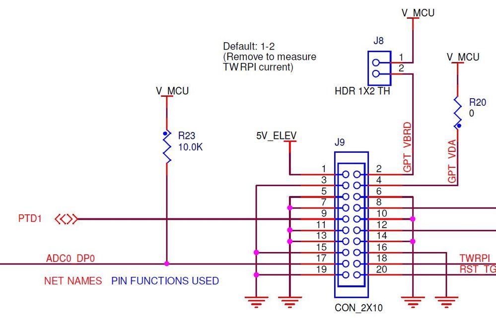

      The messages is temperature data got by DS18B20.I want to monitor several points with 8 devices in all.But I did not get any helpful template about this,can you give me some advice?Which pin can be used to connect to 18B20 on the TWR-KW24D512 board or some documents ?

I am using the BeeStack codebase for the application. I am using the GPIO PTD1 for DS18B20 DQ pin,and I want to know whether it is avaliable or ocupied on the TWR-KW24D512v board.But the results I got were always  +  0.0 .I think it maybe something about the CLK in the CPIO confignation. I write it like this:

The PTD1 is pin 8 of MKW24D512 device. It is available in pin 9 of J9- 2x10 connector of TWR-KW24D512 board (See image below).
If you are using BeeStack codebase, I would strongly recommend you to use the available GPIO configuration functions such as GPIO_EnablePortClockGating(), GPIO_SetPinPortAttr(), GPIO_SetPinDir(), etc. You may refer to LED.c file as an example of how to configure the GPIOs.
As a side note, your CL_DQ definition might not be clearing the bit as expected.  You should use gSENSORPortDataClearReg_c &=~ gSENSORPin_c instead.
