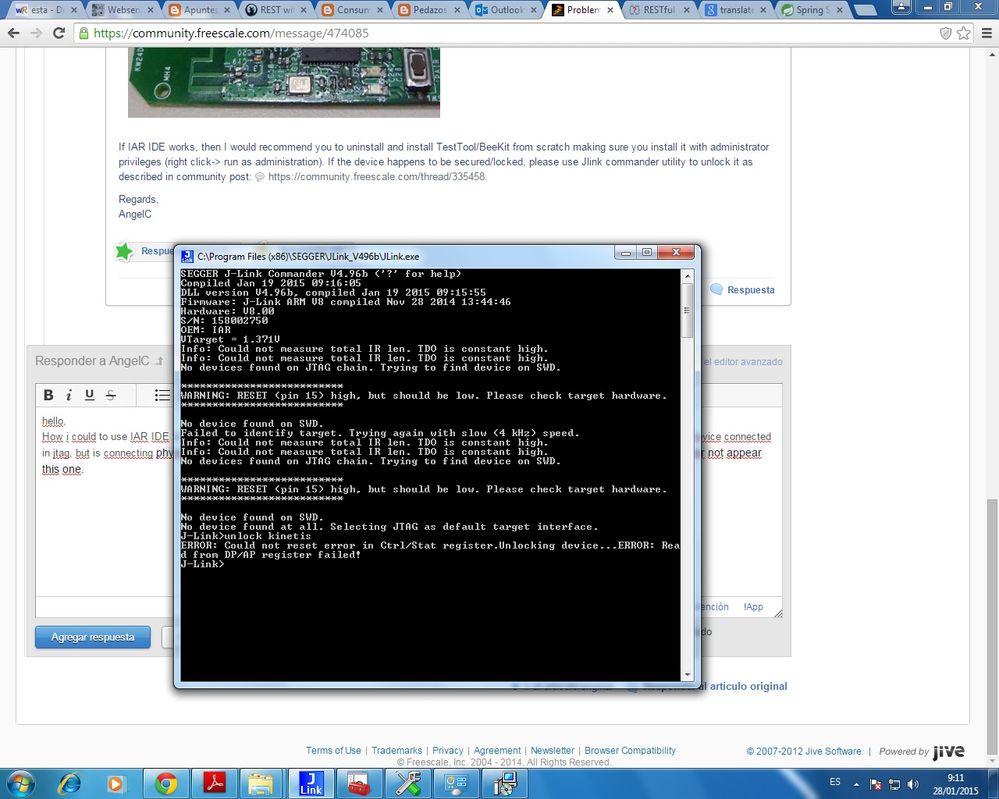

danielvega
hello,
How i could to use IAR IDE to flash the USB-KW24D15? I need a code for flash?? Also i want to mention that in jlink-comander not appear no device connected in jtag, but is connecting physically . What can be the reason?in manager device shows virtual com for my device,but in jlink commander not appear this one. see picture :
Thanks.

AngelC
Senior Contributor I
Hello Daniel,
If JLink connections have been verified to be ok, and board is listed as a COM port indeed, then it should be detected by the Jlink. Have you tried in another computer? Normally you could flash the board using IAR too, but if Jlink commander is not finding the board, the IAR will not either.
