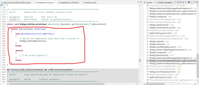

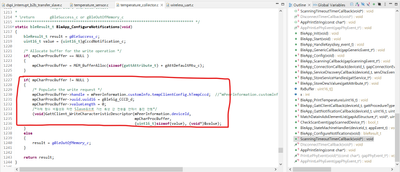

When running the example, the "Client (Temp Collector) device" sends commands to the "Server (Temp Sensor) device", and the "Server" measures the temperature and sends it to the "Client". During this process, it seems that information containing 'cccd' and 'uuid' is being sent.
["BleApp_ConfigureNotifications(void)" function in 'BLE_temperature_collector.c']

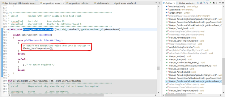

After the 'Client (Temp Collector) device" sends a command, the 'Server (Temp Sensor) device" recognizes the command, measures the temperature, and transmits it to the 'Client'.
["BleApp_GattServerCallback (deviceId_t deviceId, gattServerEvent_t* pServerEvent)" function in 'BLE_temperature_sensor.c']
I understood that the value of "pServerEvent->eventType" should be set to 'gEvtCharacteristicCccdWritten_c' so that the "Server(Temp Sensor) device" can recognize the command from the "Client(Temp Collector)" and send the temperature through the Switch() function.
However, I am currently unable to find the process (code) to set the value of "pServerEvent->eventType" to 'gEvtCharacteristicCccdWritten_c' in the 'BLE_temperature_sensor.c' code.
Where can I find the process (code) for setting the value of "pServerEvent->eventType" to 'gEvtCharacteristicCccdWritten_c' in the 'BLE_temperature_sensor' code?

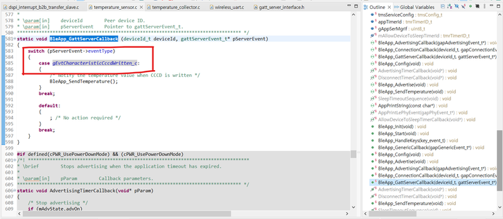

If you look at the 'BLE_temperature_sensor.c' code, you can see the 'BleApp_SendTemperature();' code, which sends the temperature from the "server (temp sensor) device" to the "client (temp collector) device."
In order to transmit the temperature, you can see that "pServerEvent->eventType" of 'BleApp_GattServerCallback (deviceId_t deviceId, gattServerEvent_t* pServerEvent)' must be "gEvtCharacteristicCccdWritten_c".

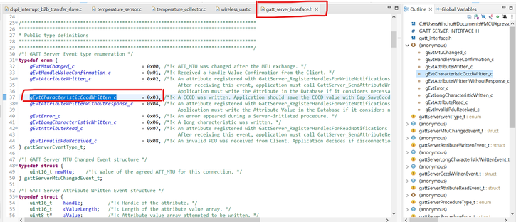

So, I looked up 'gEvtCharacteristicCccdWritten_c' and saw that it was defined as "gEvtCharacteristicCccdWritten_c = 0x03" in 'gatt_server_interface.h'.
1. As soon as the 'cccd' received from the "client (temp collector) device" is written, does it automatically become "gEvtCharacteristicCccdWritten_c = 0x03"?
2. Or is there a process (code) that sets "gEvtCharacteristicCccdWritten_c = 0x03" in the "server (temp sensor) device" when a command/request is received from the "client (temp collector) device"?
I think number 2 is correct, so I'm looking for the process (code) to set "gEvtCharacteristicCccdWritten_c = 0x03" in 'BLE_temperature_sensor.c'.
In which part of 'BLE_temperature_sensor.c' does the process (code) of setting "gEvtCharacteristicCccdWritten_c = 0x03" take place?

As you mentioned, bleResult_t BleApp_ConfigureNotifications(void) from source/temperature_collector.c is used to enable temperature notifications by writing peer's CCCD of the Temperature characteristic.
This function calls GattClient_WriteCharacteristicDescriptor API which initializes the Characteristic Descriptor Write procedure for a given Characteristic Descriptor. This API may be handled by the Stack library and it is described in the Host Stack API Reference Manual, Section 5.10.19.

According to the Bluetooth Core Spec 5.0, a client may write this configuration descriptor to control the configuration of this characteristic on the server for the client, so, the server is allowed to send indications or notifications.
Once the CCCD has been written, the event gEvtCharacteristicCccdWritten_c is generated by the Stack on the Server side so the Server can send the value to the Client.
