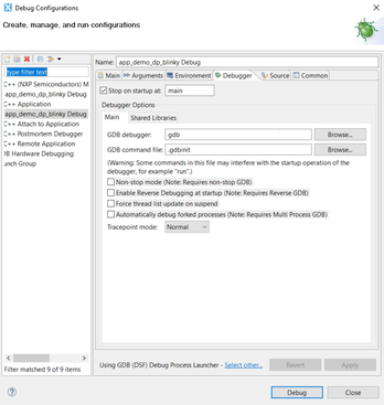

driesmoors
What steps did you take to import the NHS3152 SDK in your workspace? Can you also give a screenshot of your IDE?
Best,
Dries.

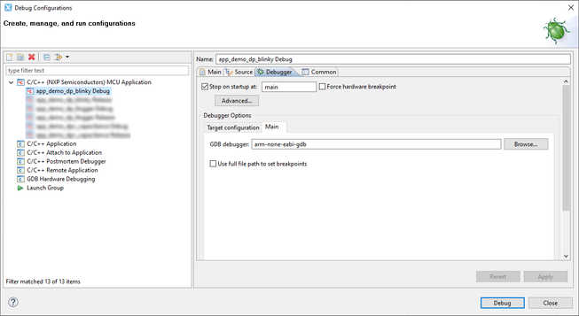

Pel
I imported the .zip of the SDKs with the Import project(s) from the 'start here' window. I simply pointed the 'project archive (.zip)' section to the .zip of the SDKs (release_mra2_nhs3152.zip).
I attached the screenshot of my IDE.
Alexandre Pellerin.
12,215 Views
driesmoors
The DGB debugger in your build configuration should say arm-none-eabi-gdb, which then refers to the file C:\path\to\LPCXpresso_8.2.2_650\lpcxpresso\tools\bin\arm-none-eabi-gdb.exe
Can you check?
Dries.
12,212 Views

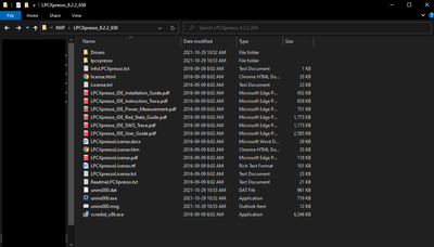

Pel
Hello Dries,
When I follow the path I don't see the tools folder in the LPCXpresso one:
As for now I'm not using the arm-none-eabi-gdb.exe for my gdb debugger since I don't have access to it.
I'll try uninstall/reinstall-ing LPCXpresso. If it doesn't, is there a place where I can get the tools folder ?
Alexandre Pellerin.

Pel
This is the LPCXpresso folder when I download LPCXpresso with the 'Installer: LPCXpresso v8.2.2 for Windows' :
(No tools folder)

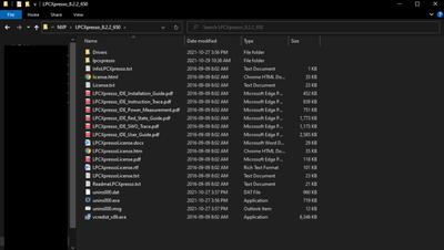

driesmoors
There is no other way to get the correct tooling, it must come together with the installer.
Can you check inside the lpcxpresso folder? There should be a tools folder one level deeper.
Best,
Dries.

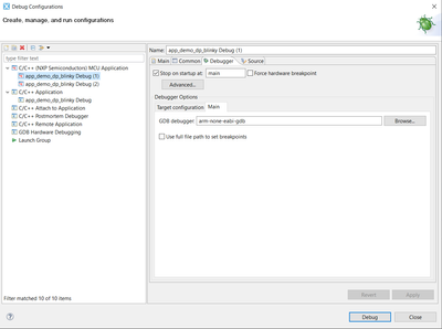

Pel
Hello dries,
I found the tools folder and the arm-none-eabi-gdb and I pointed the debug option to it:
Here's the C/C++ application window where I changed gdb.exe
Unfortunately, I have the same error when I tried to debug the project:
(Sorry I missclicked 'accepted as solution ' when trying to Reply to you)
Alexandre Pellerin.

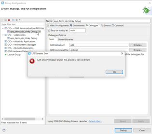

Pel
Hello Team,
I tried to create a new workspace and regroup the SDK in the NXP folder to test if it was a path issue. It didn't work unfortunately.
When I tried to run the example project without any changes to the debugger, the following error appear:

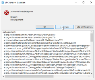

When I tried to go to the '(NXP semiconductor) MCU application' this error pop-up:
If I run the debug after, the following error stop it:
Exception
Reasons:
Error from StubMonCapabilities: -interpreter-exec console "mon capabilities": msg=""monitor" command not supported by this target."
I not sure how to interpret it.
