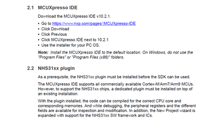

I'm trying to debug some code on the NHS3152. I want to read some of the peripherals as explained in UM11153. When I open the peripherals+ window during debugging I get the error: Not a valid SVD File. I have attached the error message to the post.
Where can I find the SVD file for the NHS3152/NHS3100?

Hi @ChristianP
Please refer to UM11153,   download the MCUXpresso IDE v10.2.1 , and install NHS31XX plugin.

Thanks for your response! I seem to have missed the version requirement in the manual. I installed the older version, however, version 10.2.1 does not support the MCU-link (only version 11.1 and later). So I will use the newest version and not use the register function as it seems to not work in the newer version.
