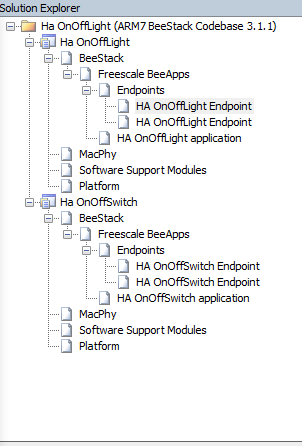

Once done that, you will need to make further modifications (add endpoints, define LEDs to be used with every endpoint, etc) in order to control the more LEDs from sensor nodes. Also, if you would like the sensor nodes to have LEDs to be controlled, then you will need to add the corresponding endpoints in both coordinator and sensor nodes. In brief, you will need:
Network node: 4 OnOffLight endpoints and 2 OnOffSwitch endpoints
Sensor nodes: 1 OnOffLight endpoint and 2 OnOffSwitch endpoints
Fortunately, BeeKit allows you to add several endpoint to an application in a very easy way. Simply right-click in “endpoints” once in the solution explorer (before exporting it to IAR) and select the “add software component” to add the desired endpoints. You will get something like the following figure:
You will need to change the endpoint numbers since all of them will have the number 8 assigned by default. To change it, simply select the desired endpoint and open its simple descriptor. It should look as follows:
After exporting it to IAR, you will need to do some other modifications to the source code that will require to first get familiar with the code. You should first implement a way to bind the different endpoints with their corresponding LEDs/Switches and then change the SW actions to send On/Off commands to the specific endpoints.

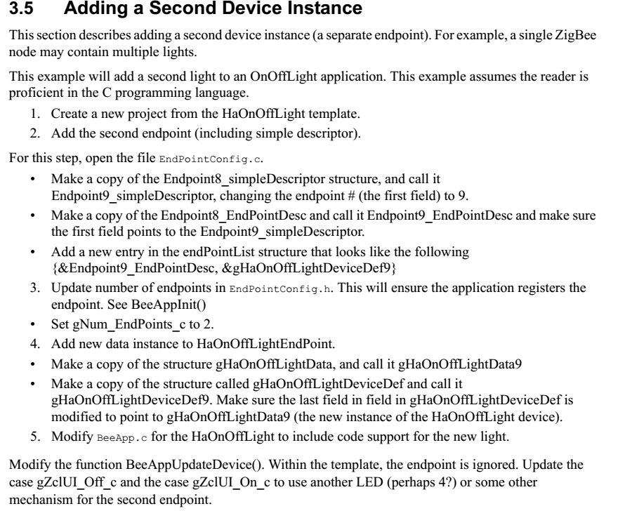

I have read "3.5 Adding a Second Device Instance"  in "ZigBee Cluster Library Reference Manual" document but it not in detail
You can guide me add new endpoint (include modifier in each file source code)?

You could add the endpoints using BeeKit solution explorer as described before and simply modify BeeAppUpdateDevice() function in BeeApp.c file. As the documentation states, endpoint number is ignored in the default template, but you could easily add a check and select the LED to turn ON/OFF based in the endpoint addressed. For instance:

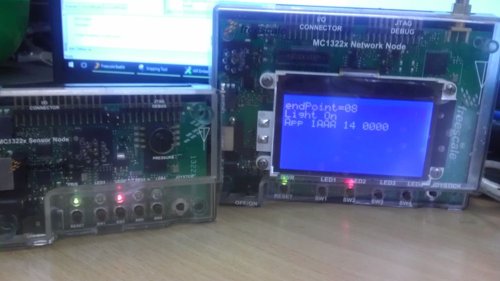

In Ha OnOffLight I creat two HA OnOffLight Endpoint with Endpoint Number  value is 8 and 9
In Ha OnOffSwitch I creat two HA OnOffSwitch Endpoint with Endpoint Number  value is 8 and 9
In BeeApp.c of Ha OnOffLight I add code in  BeeAppUpdateDevice() function to display endPoint value
case gZclUI_Off_c:
      ASL_SetLed(LED2,gLedOff_c);
      ASL_LCDWriteString("Light Off" );
      ExternalDeviceOff();
      LCD_WriteStringValue("endPoint=",endPoint,0,gLCD_HexFormat_c);//mcbk add
      break;
    case gZclUI_On_c:
      ASL_SetLed(LED2,gLedOn_c);
      ASL_LCDWriteString("Light On" );
      ExternalDeviceOn();
      break;
In BeeApp.c of Ha OnOffSwitch I add modifier code  in  BeeAppHandleKeys() function to send command to the Light
case gKBD_EventSW1_c: /* Sends a Toggle command to the light */
      lastCmd = gZclCmdOnOff_Toggle_c;
     //OnOffSwitch_SetLightState(gSendingNwkData.gAddressMode,aDestAddress,EndPoint,lastCmd, 0);
      OnOffSwitch_SetLightState(gSendingNwkData.gAddressMode,aDestAddress,9,lastCmd, 0); // Add Endpoint = 9
      break;
    case gKBD_EventSW2_c: /* Sends a On command to the light with acknoledge */
      if ((gSendingNwkData.gAddressMode == gZbAddrModeIndirect_c) || (gSendingNwkData.gAddressMode == gZbAddrMode16Bit_c))
        lastCmd = BeeAppGetSwitchCommand(0);
        OnOffSwitch_SetLightState(gSendingNwkData.gAddressMode,aDestAddress,EndPoint, lastCmd, gApsTxOptionAckTx_c);
      break;
But when I press key1 on OnOffSwitch, LCD on OnOffLight I not receiver endpoint =9, only dispplay endPoint =8
How do I get two endpoint difference (8 and 9) on Ha OnOffLight when send command from Ha OnOffSwitch?

Please make sure you are using direct addressing mode (16-bit). It could be that the default application uses indirect addressing and therefore it is based in the endpoint binding, which you are not implementing for the rest of them added.
I would recommend you to use direct addressing and set the network short address (coordinator is always 0x000). If you would like to use indirect addressing, then you will have to implement a mechanism to bind the different endpoints to their corresponding destination endpoint, which will require some changes to the code.
