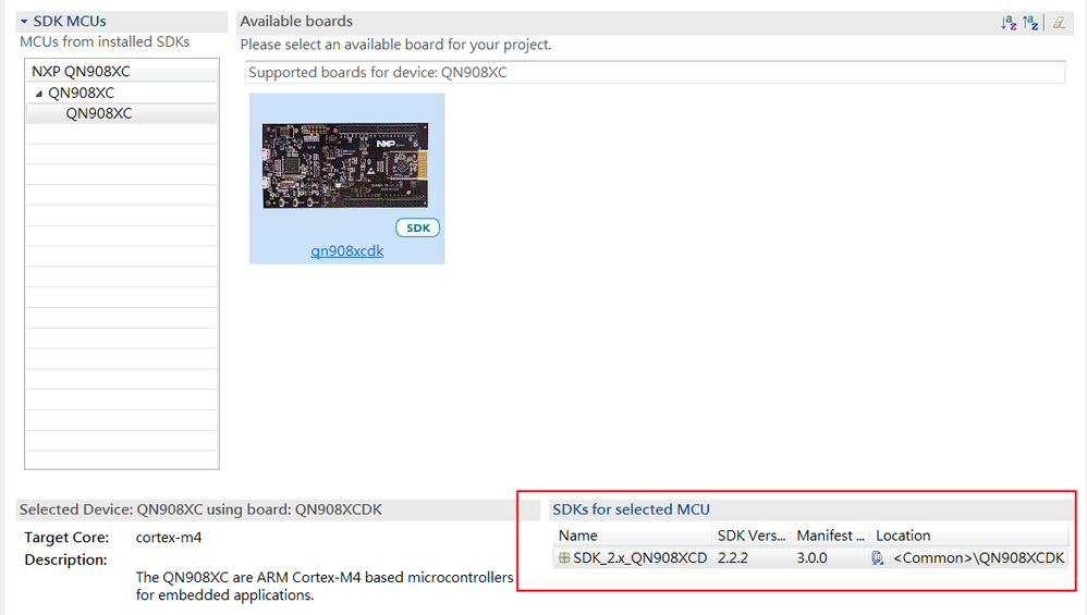

wang_barry
Hello @estephania_mart
Got it, below is the SDK version screenshot from MCUXress IDE

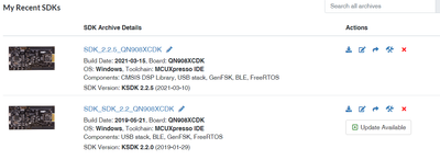

estephania_mart
Could you please help me check the MCUXpresso Dashboard? I believe that there was a new version released on Monday
Estephania
2,772 次查看
wang_barry
 Yes, it seems to have the latest SDK version 2.2.5 that released in 2021.03.10
   I should update it
