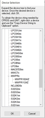

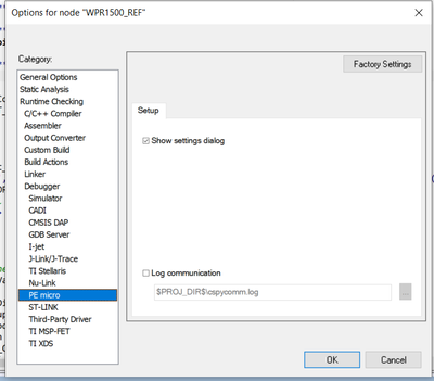

Hello community,
I would like to flash my MWPR1516 component with the software. For the moment, i only have the IAR version for the board. However, the user guide is not on date and IAR change quite a bit.
When i configure my debugger, i choose my PE Micro and i would like to configure it in SWD.
But i can't do it. (see the config panel below)

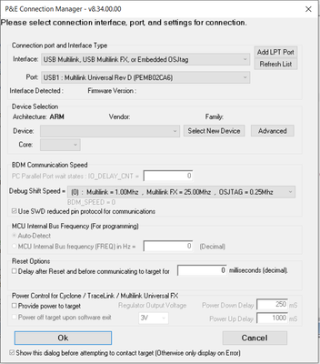

So, i choosed to continue and see what is happening. When i go further to download & Debug, an other configuration panel appears. (see below)
It seems good but unfortunately, when i choose a new device, the MWPR1516 is not in the list.
Is it working if i choose the MWPR1124Z (i tried and it doesn't seem to work).

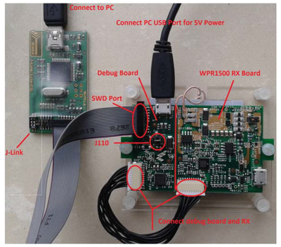

xiangjun_rong
I suppose that that the hardware connection on the board has issue.
I attach the WPR1500LDOMPUG.pdf, pls refer to section 6.2.1 Connecting the J-Link debugger, the two white connectors should be connected by wires.
Hope it can help you
XiangJun Rong

Second, i find well the MWPR1516 in 'Project' -> 'Options' -> 'General Options' -> 'Target' -> 'Device'. However, i don't find it in the config panel of the connectivity (the picture in my first demand).
I just find a sensor form kinetis called WPR1516M2 but i can't find what it refers to. Is it really my MWPR1516 ? And so why is it in the sensor section ?
It will be a bit difficult to transfert from IAR to Codewarrior. If i refer to the datasheet, NXP has the Codewarrior version too. I will contact them throw a ticket to know a bit more about this.

olivier_ctm
When I m in the IAR environment, i found a device WPR1516M2. Is it the MWPR1516 ? The weird thing is that it is in the sensor category.

xiangjun_rong
Pls try to select WPR1516M2 and SWD port in IAR IDE
XiangJun Rong
4,990 Views
olivier_ctm
Thank you, it works well now.
