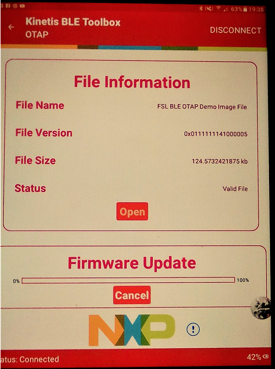

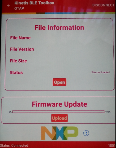

To test the OTAP program, after connecting you can see device info profile by pressing the :smileyalert: (exclamation mark in circle)
and open a file.
What type of file do I need to open to upload ?

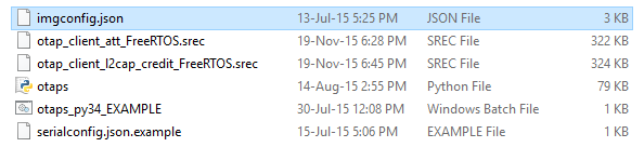

Got C:\Freescale\KW40Z_Connectivity_Software_1.0.1\ConnSw\tools\ble_otap
Should I use the srec file or the img file after using the python script or bat command ?
Inline image
O can I use bin files ?
C:\Freescale\KW40Z_Connectivity_Software_1.0.1\ConnSw\tools\binaries

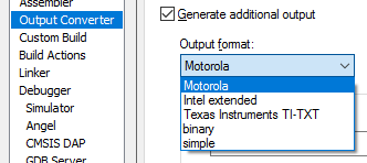

IAR 7.5 output file selection:
- srec
- img
- bin
- other

Hi Lucian,
Did you take a look for the next DOC? The KW40 only supports .srec files.
https://community.nxp.com/docs/DOC-332325
Let me know if you have the same problem.
Mario

srec files seems to be valid.
But what can be the reason that the update don't start ?
Thank you,
