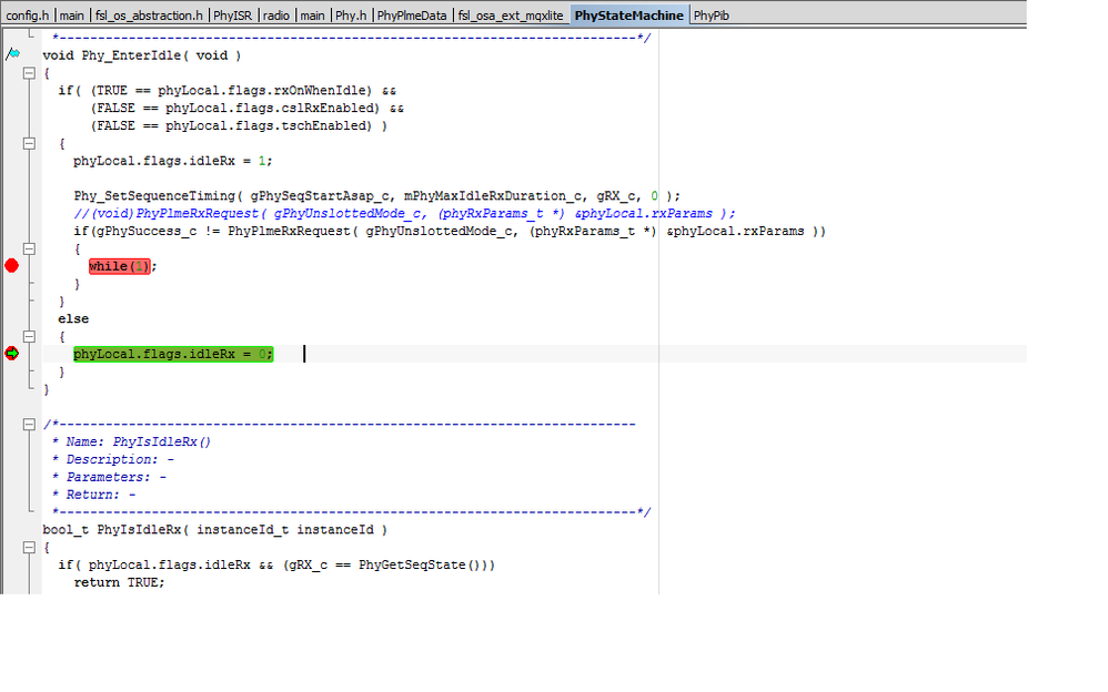

rmkulkar
Hi Luis,
Yes, we do have 4 LEDs that we can play around with but no UART. Where do you suggest that we toggle the LEDs?
Btw, we just happened to come across the bug with the debugger attached. I know this is going to sound very weird but rxOnWhenIdle was set to 0 and hence the Phy "correctly" went into the idle mode. Please find the attached screenshot. I'll restart the testing after setting a breakpoint in PhyPlmeSetRxOnWhenIdle, which seems to really be the only place rxOnWhenIdle is updated, to check why this value was updated. There are 2 places in the app code where rxOnWhenIdle is set but both of them set it to true, so I'm not sure how or if the app the could cause this issue.
So, however bad it does sound, for now, as a workaround, can I just check if rxOnWhenIdle is true and set it to true if it is false from the app's main loop? What could be the side effects of unnecessarily using the SAP_Handlers from the main loop?

rmkulkar
Hi Luis,
The screenshot from the last reply was spurious. Turns out the watchdog got triggered and the breakpoint was hit from the Init code path. In that context, the rxOnWhenIdle being 0 makes complete sense. I'm extremely sorry for making you chase the wrong code path.
That said, the original problem still exists where the radio incorrectly goes into the Idle state. I'm having a hard time reproducing the bug with a debugger attached and have no additional information to share at this time. In the mean time, can you please help me with a patch where the app can check if the Phy is idle and somehow force a dummy event to retrigger the Phy task? This bug is now holding up the production and we need to urgently find a work around before flashing code on to the next batch of devices.
