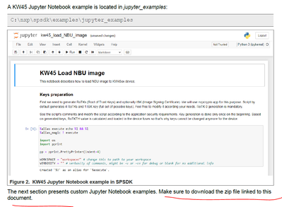

I am using **SPSDK version 3.2.0** along with the following files:
Could you please confirm if there are any changes required, or provide the updated versions?
In AN13883, it is mentioned that a zip file is available, but I could not find any such file attached.
Additionally, when I go to the location:
C:\nxp\spsdk\examples\jupyter_examples
and open kw45_load_NBU_image, I get a compilation error, it is from 2023.
Could you please confirm if this example file has been updated by NXP?
