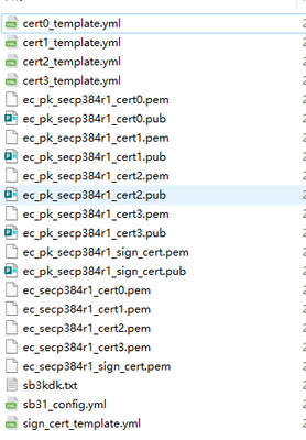

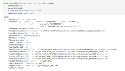

Dear Sir,
         I tried to burn NBU through SPSDK by looking at AN13883 , The version of python I use is V3.11.6。But I had a problem running script 5.2, My sb3 file cannot be generated。
@KW45

Melton
Thank you sir,
      I followed the link you provided and modified some content, now it has been solved.The problem may be that the version written on AN is older.

Ricardo_Zamora
Could you please confirm that you followed all the "KW45xx and K32W1xx Load NBU image" jupyter example?
What modifications did you make?
