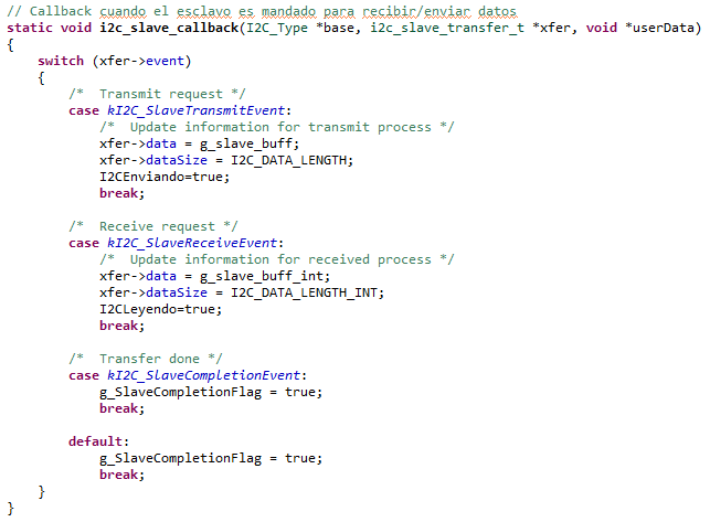

The objective of my project is to communicate to my Raspberry PI through I2C when I make use of a CoAP petition from the user. I used "frdmkw41z_wireless_examples_thread_router_eligible_device_freertos" as project base and I configured the KW41Z as I2C slave (from the driver_examples_i2c_polling_transfer) because RP is my I2C master:
When there is an I2C transfer the next callback is called (a 32 byte buffer to transfer and a 1 byte variable to receive):

I am sorry to come another time to this I2C issue. In this time, we would like to receive an int data to my KW41Z from my RP instead of a byte like I posted before. I attach the code of the KW41Z slave callback where the read buffer is g_slave_buff_int and the length is I2C_DATA_LENGTH_INT:
#define I2C_DATA_LENGTH_INT 2U
uint8_t g_slave_buff_int[I2C_DATA_LENGTH_INT];

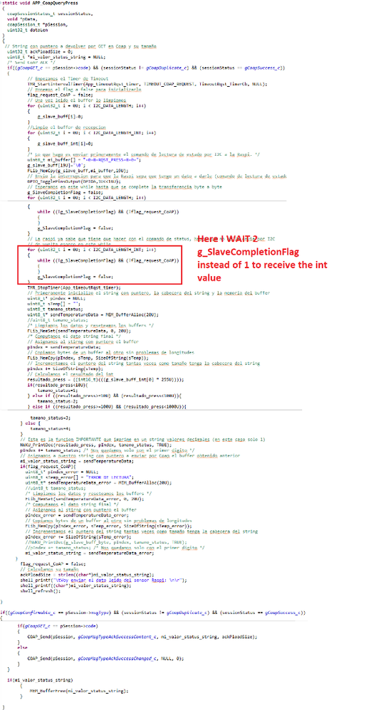

The CoAP callback used is similar to that I posted here, but instead of waiting just 1 g_SlaveCompletionFlag I wait 2 because I send 2 bytes (1 int) from my RP:
I used the Timer that Alexandru posted in order to avoid the KW41Z to get stuck, but I do not understand why, in some cases I receive 2 flags and I receive the int correctly and in other cases I only receive 1 flag and the Timer takes place. In my RP I send one byte I wait 0.1 secs and I send other byte (with SMBus python library).
The I2C communication fail issue is due to my RP? Or the Slave Operation in interrupt transactional method for the KW41Z is not suggested to be used with the wireless_examples_thread_router_eligible_device_freertos?? I should use I2C Slave FreeTOS Driver instead to avoid this bad behaviour?

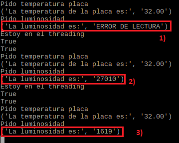

I followed your advices, I removed the for block and I send from raspi the 2 bytes at the same time with the function write_i2c_block_data(int addr,char cmd,long vals[]) of the smbus python library of the RP. I obtain the following data:
1) Is the error that reports me the Timer took place (so even if I put only a flag the coap callback gets stucked)
2) Is an incorrect value that I do not understand why I receive this
3) Is the correct value of the data I want to know
These values are almost periodically sent as I can see. Also I realized that when I periodically send Coap request to get the data the KW41Z resets after some minutes of working (I think it is due to the several interrupts performed in the I2C callback) but continues to perform the requests.

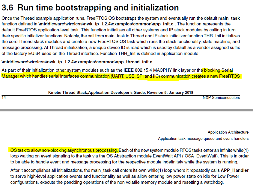

I saw from Kinetis Thread Stack Application Developers's Guide.pdf a serial manager that may help to handle I2C communication in wireless_examples_thread_router_eligible_device_freertos base program, but I do not know how to use it:

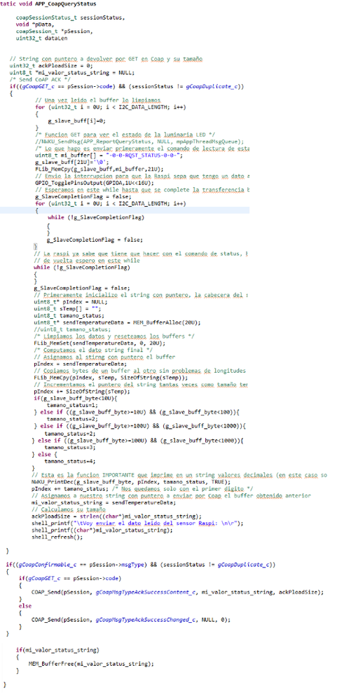

In the CoAP callback function you are using, is it possible that you missed out the case in which a duplicate message is sent. Take a look at the enum coapSessionStatus_t, you have the option gCoapDuplicate_c, which helps you dealing with such situations. By default, in the CoAP callback from SDK, duplicate and success statuses are treated the same, maybe you did the same in your function.
Let me know if this was the problem.
Lilian
5,772 Views
diegocomin
Hello Alexandru-lilian,
With the option gCoapDuplicate_c added my code appears like that:
Thanks a lot Alexandru! The result has improved notably and in the most of the cases when I request a CoAP GET the CoAP callback is only called one time and I receive the response from the RaspberryPi. However in some few cases the CoAP callback is called twice as before and in other cases the CoAP is called once but I do not receive thorugh the CoAP the data requested to theRP (and the RP is not the problem because I see it has sent the right data to KW41Z via I2C).
