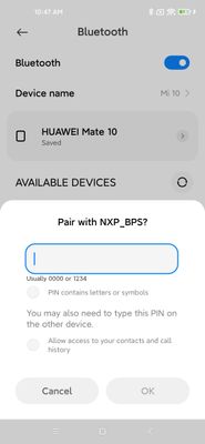

jefthadsilva
Thank you for your response.
gAppUseBonding_d and gAppUsePairing_d are enabled in both Central and Peripheral. Privacy is disabled in both.
I have tried with the phone using the "BLE Scanner" app on the phone. And Pairing and Bonding works fine. So I suspect the Central here. I am already referring to the Developer guide and I have followed the suggestions there.

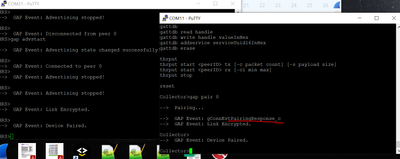

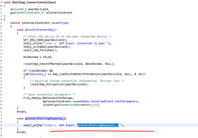

nxf56274
I use ble_shell example. I add this code in connection callback to test if the client can receive the gConnEvtPairingResponse_c when pair.
The result shows that the client can receive the 'gConnEvtPairingResponse_c'.

nxf56274
Before doing the service discovery, I do the paring.
Actually, If you try other paring examples, they always ignore this case 'gConnEvtPairingResponse_c'. So I think we do not need to check 'gConnEvtPairingResponse_c'.

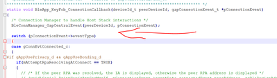

22,966 Views
nxf56274
Print every event we receive in here. Let's check the connection sequence. And check which event is handled by mcu before time out.

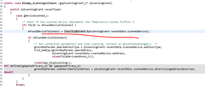

nxf56274
Do another test. Use the example 'temperature_collector ' without any modification. Use it to connect and bind. Does it work?
You need to modify the client scan callback. It will check if the scanned device has temperature profile. If your device doesn't contain, it won't connect to device. If your device doesn't contain the temperature profile, you would better comment this code. Use other way like device name to find specified device.

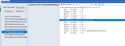

With the KW38 Eval board (with MCUXpresso IDE) acting as the Central and our Custom hardware working as the Peripheral we see the same observation.
  1. Used the temp_collec example with the modifications you suggested to connect to the Peripheral. Connection is established but then when Pairing is initiated, we see the same timeout.
  2. Used my custom Central application on the Eval Board and I see the same issue again.
Is it possible to get logs of the Stack in MCUXpresso IDE for EVB to see what is going on inside?

You'd better buy a ble sniffer. Analyzing the packet is more efficient.
22,818 Views

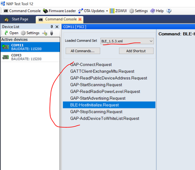

nxf56274
The ble lib is invisible to us. So it's hard to get the information. The last way to try to find out the problem is  using the Test tool. Use another board flashed with the fsci_black_box. The test tool provides the hci interface and it has the log about the hci commander.
Use this to control the device acting as the central. And check the log. This may help us.
