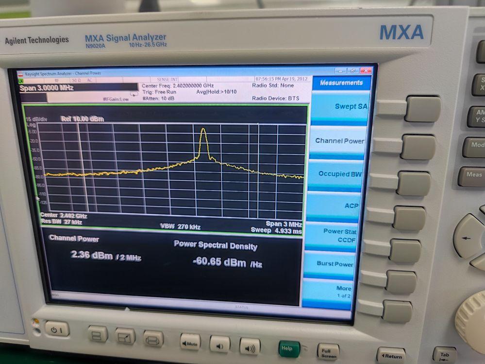

Hi Sir,
We measured KW38 BLE RF output power level is about 3.1dBm at ch39(2480 MHz) after tuning rf matching. But I see KW38's output power level can be up to 5 dBm with LDO-HF bumped.
I am not sure if LDO-HF bumped  is enabled or not on our Board. Could you please tell  me how to enable LDO-HF bumped function on KW38?
HW: MKW38
Software: a binary code (connectivity software from SDK_2_6_15_FRDM-KW38)  was loaded into KW38.

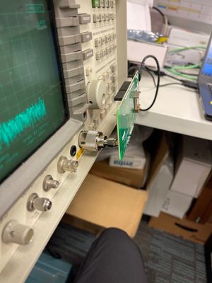

jasonchiang

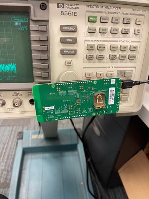

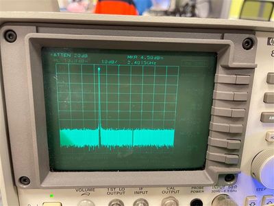

Hi Robin,
     Sorry for late. See my setup and test results below.
4.5dBm output power at SMA connector port. Overall loss (from RF pin to SMA connector) = 0.67 dB, So 4.5+0.67=5.17 dBm. It meets typical output 5dBm of KW38 specification. Please be noticed that 5 dBm typical is KW38 RF pin output. I also attached the bin file which I tested and the FRDM-KW38 board setup(default setting is buck mode) for reference. From the results, it may say  LDO-HF bumped  is enabled at NXP frdmkw38_connectivity_test project file.

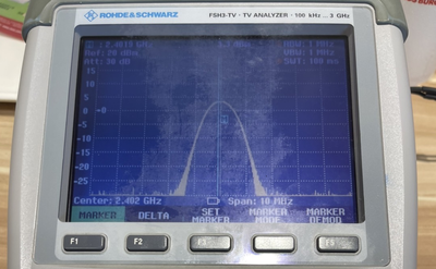

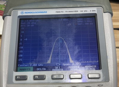

    Your results is not the same as mine here. I can got the test results below using FRDM-KW38.
Hi Power 31 mode, I got around 3.3 dBm output.
Lo Power 31 mode, it is 1.6dBm output
May I have your help to test again to verify the attached bin file generated from my side and see if there is different output level using Hi power / Lo power mode for your board ?

jasonchiang
Hi Robin,

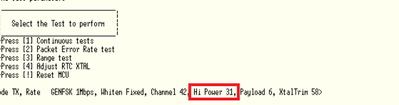

jasonchiang
Hi Robin,
    Sorry for late.

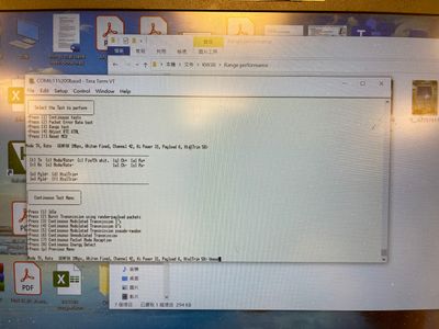

    I checked connectivity S/W, GENFSK_ConfigurePower inside genfsk_utils.c. I saw BumpPaPowerUp function enabled for Hi Power. We have Hi Power 31 and Lo Power 31 command. Just check if you perform Hi Power 31 from your console below.
In parallel, I am working to clarify if any H/W modification required. I will give you update soon.
