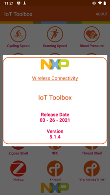

Lincoln
Hi @mario_castaneda,
It is still failed to work with the bleota file.
I cannot see where goes wrong.
Here is my IoT tool version, which seems different from yours?
And I follow the process below:
  1. Programm the bootloader OTAP example
  2. Programm the OTA ATT example
  3. Pairing and Bonded with my Android smartphone
I am working with FRDM-KW36 SDK 2.2.9
Is there anything I missing?
Or an alternative can be implemented?
Thank you.
