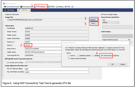

I am working on using CAN bus to upgrade image on kw36 by following the attached document's process.
I generate the bleota file which is attached below by using NXP test tool 12 according to
Chapter 3: Image obtaining

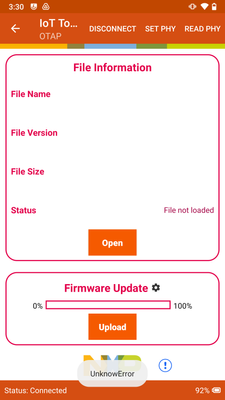

After IoT toolbox app connected with CAN Node A v1 board successfully, I press open button to load the bleota file but which is failed and the error can be seen in the picture below.
How to upload a bleota file ?
Thank you for helping!

Lincoln
Hi @mario_castaneda,
After my testing, it turns out that IoT Toolbox app does support .s19 file but not support .bleota file.
Every time I upload .bleota file to the app, it would show "unknown error" as I already mentioned.
As for this case, using NXP Test Tool 12 to modify image id to 0x000A  is required for CAN bus image upgrading process. However the image would be saved as .bleota file which cannot be loaded into IoT Toolbox app for OTA purpose.
What is the solution for this case?

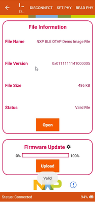

mario_castaneda
Hi @Lincoln,
I tested by my side using the bleota file and it works.
Is it possible that you could share the bleota file?
Mario

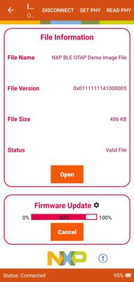

mario_castaneda
Hi @Lincoln,
I tested your bleota file, and it works. The app detects a valid file.
What is the version that you have installed? My version is 5.4.1
The process that I am following is:
  1. Programm the bootloader OTAP example
  2. Programm the OTA ATT example
  3. Scan and bond with my android device. Are you working with iPhone?
  4. Be sure that the process was successful, are you seeing the exclamation symbol?
  5. Look for the file bleota and update.
Mario
