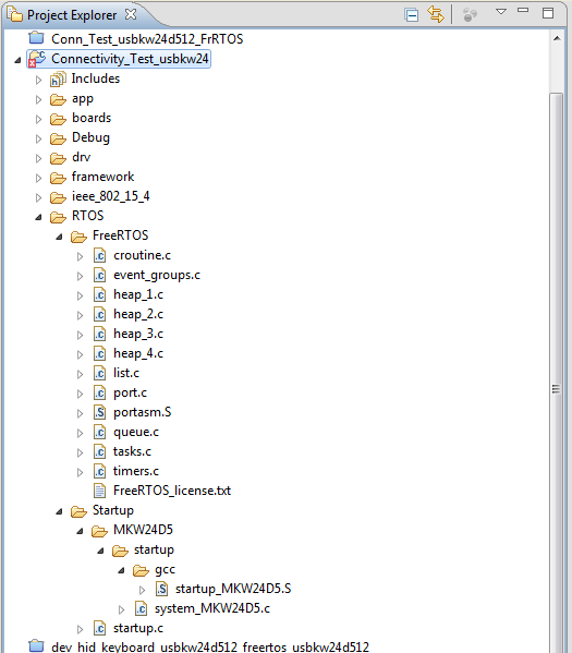

Refresh the project tree (F5)
Right-click project, select New -> Folder.
Name the folder ‘RTOS’
Add a sub-folder, call it ‘FreeRTOS’
Add another sub-folder, call it ‘Startup’
Import the .c, and .S file(s) from the folders below into the ‘FreeRTOS’ folder
C:\Freescale\KSDK_1.2.0\rtos\FreeRTOS\src\(all)
C:\Freescale\KSDK_1.2.0\rtos\FreeRTOS\port\gcc\(all)
Import the .c, and .S file(s) from the folders below into the ‘Startup’ folder
C:\Freescale\KSDK_1.2.0\platform\devices\startup.c
C:\Freescale\KSDK_1.2.0\platform\devices\MKW24D5\startup\system_MKW24D5.c
C:\Freescale\KSDK_1.2.0\platform\devices\MKW24D5\startup\gcc\startup_MKW24D5.S
In the end, the structure should look like this:

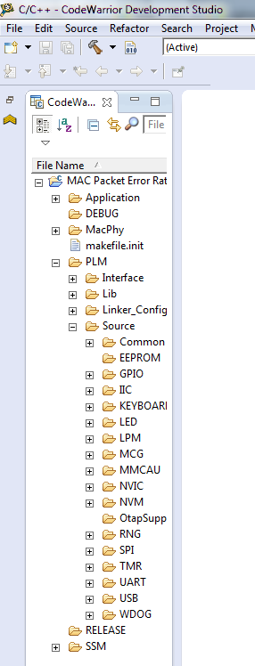

I was able to create a demo project in BeeKit("MAC Packet Error Rate Demo End Device"), and then 'Export Solution' to CodeWarrior.  The export process creates a few files, some of which I believe are compiled binaries.
Next, I imported the project into Kinetis Design Studio by meticulously following the online guide:
How to build BeeKit exported CodeWarrior 10.6 projects using KDS
After following the steps in that guide, the project did build successfully. :smileyhappy:  I haven't tried to incorporate anything from Processor Expert, or the Kinetis SDK yet, or integrate any other functionality, but at least I have a code base in KDS that might be able to transmit data via the MCR20A and KW2x.  No idea if I can use freeRTOS at this point.
4,639 Views
calebrust
[Update] It was a dead end to build the project in BeeKit and import it into KDS because the OS BeeKit generates code for is something Freescale made up, and one requirement for this project is to use FreeRTOS.
