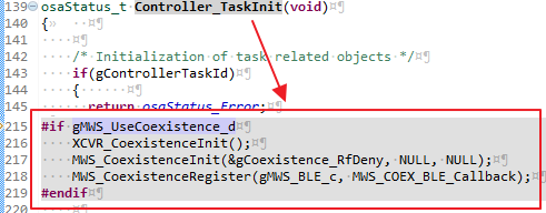

If (BLE) is to be Coexistence feature, the gMWS_UseCoexistence_d of MWS.h should be enabled.
Ble_Initialize() is going to call Controller_TaskInit() and execute XCVR_CoexistenceInit() section.

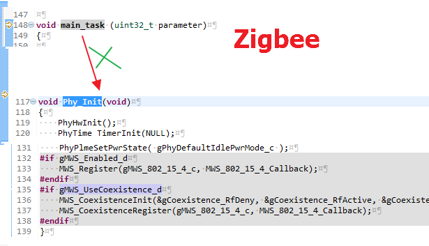

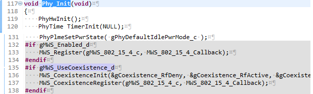

when Zigbee is going to do Coexistence , the gMWS_UseCoexistence_d flag of app_mac_config.h is also turned on.
But there is no function to call Phy_Init() to execute XCVR_CoexistenceInit() section.

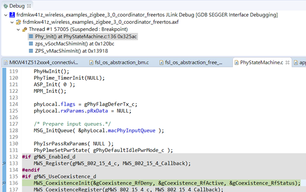

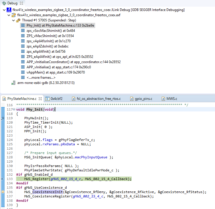

Self-test:
1. Set a breakpoint in Phy_Init() function and won't run in.
2. Put Phy_Init() anywhere in main_task(), the breakpoint can run in
QA:
1: Can KW21Z Zigbee coexistence be used?
2: Does KW21Z Zigbee coexistence have the same complete test as BLE?
3: In addition to Enable the flag of gMWS_UseCoexistence_d, where Phy_Init() should be placed in Main_task() is correct?
4: If my approach is wrong, please guide me how to open KW21Z  Zigbee Coexistence feature.

benjaminchang
Contributor V
Hi JC,
Thanks for the reply.
We did not enable gMWS_Enabled_d flag in our last test, and failed to break at Phy_Init().
We turned on the flag this time as you suggested, and it works now.
The project is just started, and the Host is from Qualcomm through UART communicating with KW21Z.
Thanks for your help!
Regards,.
Benjamin

jc_pacheco
Hi all,
I ran a quick test using the zigbee_3_0_coordinator_freertos example, enabled the gMWS_Enabled_d and gMWS_UseCoexistence_d from preprocessor options and I see the MWS module being initialized under Phy_Init() function.
Could you please specify the Wifi module you are using? By default, it will initialize the RFDeny, RFActive and RFStatus with PTA17, PTC1 and PTC3 respectively but the behavior will depend on the Coexistence protocol implemented by the Wifi module and it may or may not be implemented within the MWS example code.
Note: I used the latest SDK for KW41Z (KSDK 2.2.1 (released on 2019-08-13)) from mcuxpresso.nxp.com
JC

            Although gMWS_UseCoexistence_d is turned on,
            I have found that Phy_Init( ) is not called,
            So MWS_CoexistenceInit() will not be executed.

Being a Wifi gateway/AP, the Wifi-BLE co-existence option has been enabled  as below,
This part of code is called while Ble_Initialize(). We further verified the function by checking the related IC pins.

After checking the project code, we found the initialization part of code is inside Phy_Init().
But no body has ever called this Phy_Init() inside the project.
We wonder if this is the reason that caused the Wifi-ZigBee co-existence function not working problem?
If yes, who and where should this Phy_Init() be called?
