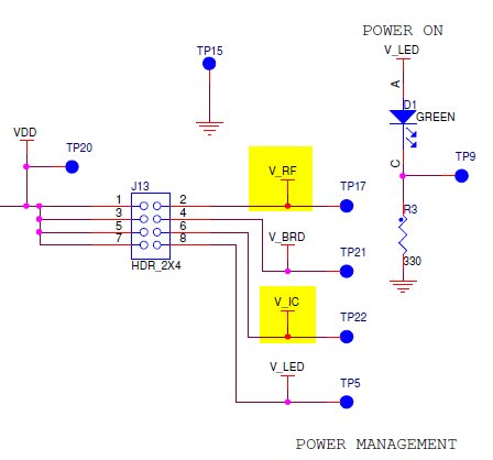

Header J13 on the MRB allows you to take measurement currents of the MCU and XCVR, refer to the schematics:
Regarding to your question about DIO0/PTE2 the answer is affirmative, you can make an external connection to a LLWU pin and wake up the MCU.
