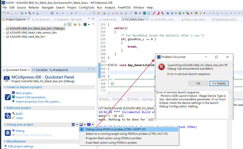

Using MCUXpresso IDE to burn K32W Carrier board via Multilink and SWD, the following error message will appear.

Dear Mario,
Thank you for your response, currently resolved.

I have tried using the LPC-link2 chip from J15 USB to SWD is OK.
2,074 Views

Hi Daniel,
Unfortunately, K32W is supporting the following probes:
Link2 debug probe with ARM’s CMSIS-DAP and SEGGER J-Link protocol options.
Boards user manual: https://www.nxp.com/docs/en/user-guide/UM11393%20.pdf
NXP open SDA J& link2:
   LPC-Link2 | NXP
  OpenSDA Serial and Debug Adapter | NXP
Sorry for any inconvenience that this may cause you.
Mario

Hi Daniel,
That is great. I am working on Multilink support.
I will get back to you in the other post.
Mario

Hi Daniel,
I hope you are doing great.
I have been programming the JN device using the SWD interface. Did you try to debug using the LPC?
Note: We are working with the Multilink. I will get back to you with some updates on this.
