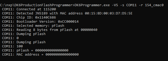

7,536件の閲覧回数
usaygo
still waiting for a way to read "Config" area (not "pFlash") from firmware code.

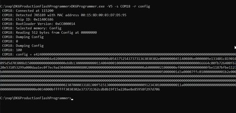

mario_castaneda
Hi @usaygo,
You could type the next command to read out the config data using the DK6Programmer.
DK6Programmer.exe -V5 -s COM18 -r config
Please let m e know if you have any further questions.
Mario

usaygo
Unfortunately, this is the way to read the pFlash area, not the Config area.
I apologize for any misunderstanding on this matter. However, if you have an answer for this, please let me know.
Question: What I want is a way to read the following "Config" area from C/C++ firmware code.
$ DK6Programmer.exe -V 0 -s COM4 -r Config:512 <= The Config, not pFlash
  COM4: Connected at 115200
  COM4: Detected JN5189 with MAC address 00:15:8D:00:05:B0:EA:86
  COM4: Selected memory: Config
  COM4: Reading 512 bytes from Config at 00000000
  COM4: Config = a41c000000000000...snip...2c196c
Just to be sure, I tried the code you gave me, but it still reads pFlash.
