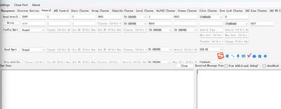

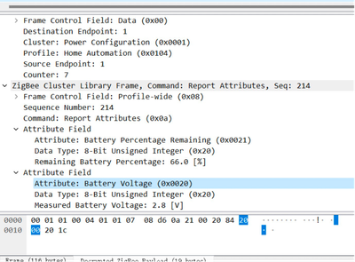

Using  ZWGUI, add an emergency button to the zigbee network ,using read attribute command to  get athe remaining battery power. The log window returns no data, but the Wireshark packet capture tool shows that there is data returned and it is parsed as the Zigbee protocol POWER CONFIG.
ZWGUI,
wireshark tools:
The question 2.  INTRUDER ALARM SYSTEM (0X0501) not support
the log view in ZWGUI can not receive data when press down the SOS button, but the Wireshark tool can capture it.
so, how can I get the data

Hope you are doing well. Maybe this community post could help you:ZigBee 3.0 Adding cluster on KW41Z - NXP Community. It is for another device, but a similar procedure should be done.
Also, we highly recommend moving to the JN5189 Wireless MCU for Zigbee® and Thread, as is our focus part for ZigBee/Thread. It is supported by our MCUXpresso IDE and MCUXpresso SDK. There are several SDK examples, like driver examples (GPIO, UART, SPI, I2C), RTOS examples, and Wireless examples (ZigBee and Thread).
If you are looking for a multiprotocol MCU, then I would recommend the K32W061/41 or the K32W041AM/A.
