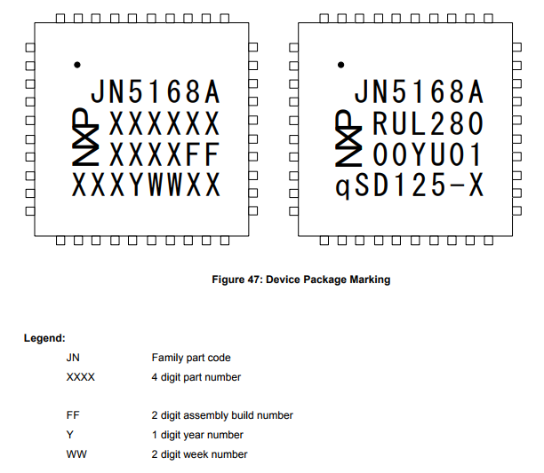

 I bought JN5169 from two different places, and I want to identify the chips from the screen and the meaning of every line.
   One is:
         JN5159
         SFG477
            1    05
          ZXD6511
   Another is:
         JN5169
         SBR976
            1    06
         ZSD5371
1,627件の閲覧回数
mario_castaneda
Hi Kyle,
The diagram below shows the package markings for JN516x.
  One is:   Year 2016 Week 51
         JN5159
         SFG477
            1    05
          ZXD6511
   Another is:  Year 2015 Week 37
         JN5169
         SBR976
            1    06
         ZSD5371
Hope it helps.
Mario
