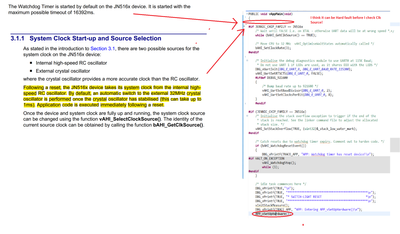

And I have others question:
What happens when nxp JN1569 "Ram usage full"?
1. watchdog Reset?
OR
2. Hard fault? and where is Hard Fault handler in code (I use BeyoundStudio and skd  JN-SW-4170).
What is the document descript it?
Thanks for your help.

3,921 次查看
manhnc
Hi @mario_castaneda ,
Thank you so much, I will implement and test it.
>> Is there any hardware failure ("hard fault") in the JN5169 chip? And where I can handle it?
Scenario, when my device real work, some device suspended (can't restart again). It works again only I power off reset it. I think it can be "hard fault" when restart (please view my image).
Thank you,

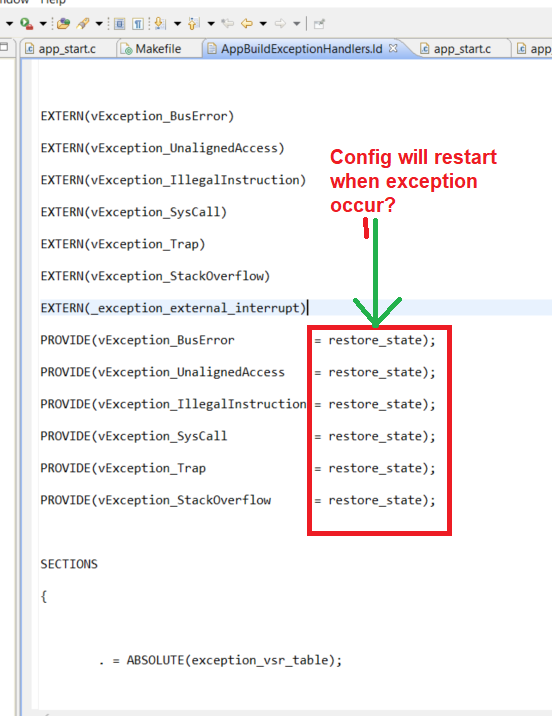

3,892 次查看
manhnc
I find more Exception in file name "AppBuildExceptionHandlers.ld". (attach file).
1. But, I don't know what exception name handle "Hard fault"? what does document descript all exception?
 2. How can I work with this file ("*.ld")?
Thank you should much!
Manhnc

3,850 次查看
manhnc
Thanks @mario_castaneda,
It useful for me. Now, I ready clear about it.
Further, I also have question:
Is this configuration (attach image) will make MCU restart (cold startup) when it occur?
